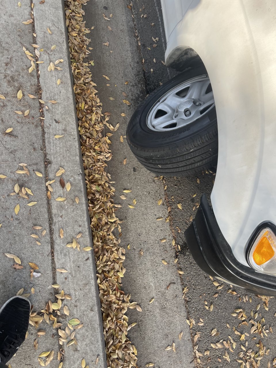

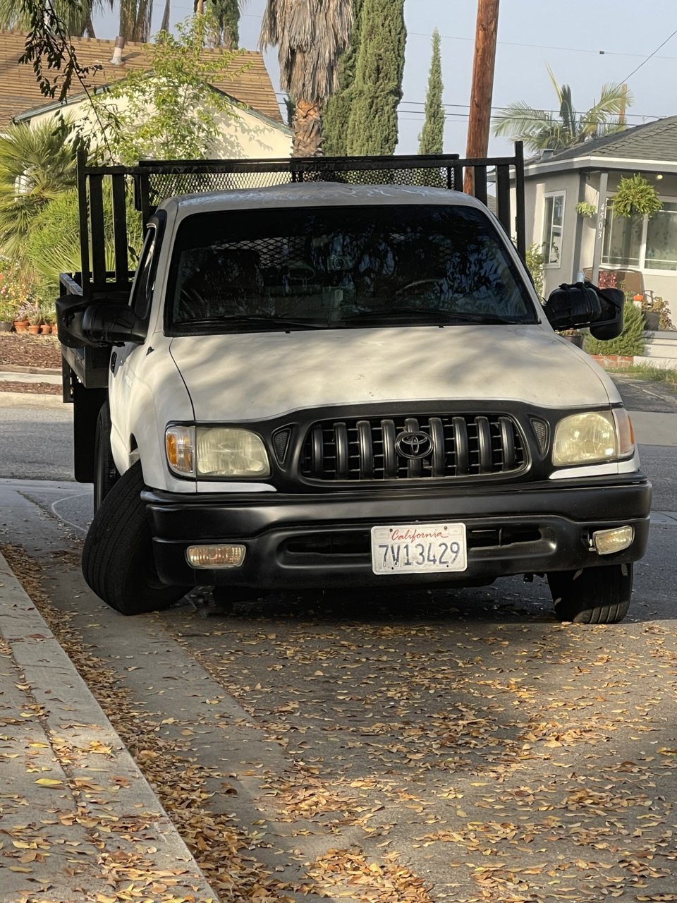

    So this happened making a left turn coming back from dropping off my lil sis, my flatbeds passenger side lower ball joint snapped off, I dragged the pos to the curb, literally a block away from my crib. I already ordered a replacement oem. Is this a straight forward repair? Or am I way over my head and should I call a shade tree mechanic cus Ive never changed one. I have 4 tacos all of them have been changed, except this one lul, this is my flatbed from my pest control days, I’m a nurse now just for you nosy folks.

    Whether or not you do it yourself, will depend on how much time and what tools you have available. Replacing the lower ball joints is not hard itself, but you probably have bent tie rods now too, in the best case. and from the look of the fluid on the ground, possibly a broken brake line.
