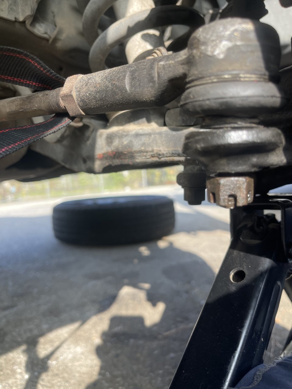

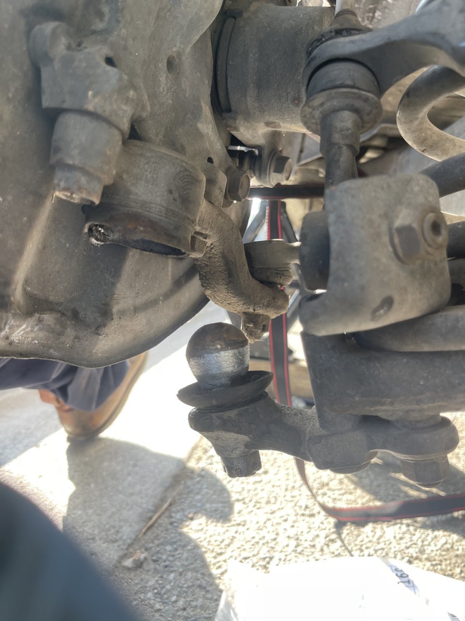

    I can’t seem to get the lower ball joint for the little ball is that where it has a screw at the bottom I keep hitting it with a hammer and it looks like it’s coming out a little bit but it looks like it’s stuck now I don’t know if I need to Pittman accessory tool or whatever it’s called but I keep hitting in it it it doesn’t want to budge
  9. Nov 5, 2021 at 5:32 PM
    #49
    goldentaco03
    goldentaco03 Well-Known Member
    Mar 12, 2015
    #150729
    1,232
    Liam
    NJ
    03 Tacoma Xtra Cab 4x4 SR5
    3in lift (Bilstein 5100, AAL), Bull Bar with halogen Hella Fogs and High Beams
    Yeah the stud has a taper that seats into the lower control arm. You’ll need a pitman arm puller to get that out since the ball joint already separated. Auto parts stores will rent you a set of them usually. At least I think that’s what you’re talking about, post a pic

    Heat up the LCA where the stud goes in.
    Another thing I’ve done is align with heat is out pressure on the castle nut side with a floor Jack and hit the LCA with a hammer.
    Or a pitman arm thing

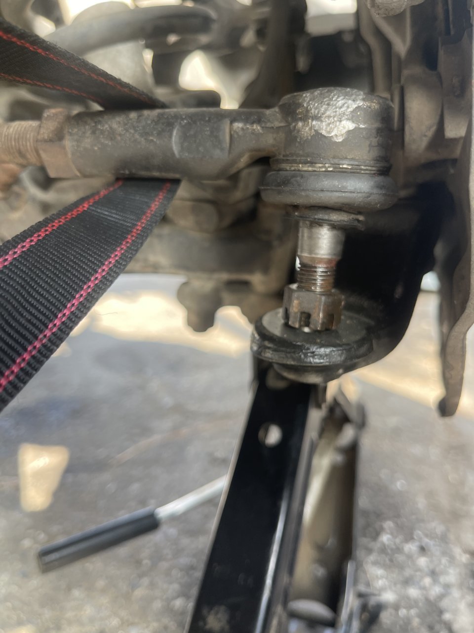

    C9B7AEF7-0114-4222-9B7A-6E6BD875C271.jpg so i got the old one out and the new in but this last place where the castle nut goes where the tie rod ball joints at when i try to put the castle nut in it just keeps spinning and its not getting torqued down….. what gives????

    So the tie rod just spins when you try and tighten the castle nut?
    if you’ve got big enough vice grips apply pressure like this

    Hit it with a 1/4" impact. As soon as it starts to catch put the torque wrench on it.

    It’s gotta A little tighter in the taper. Tap on the top of it, it will seat tighter. Place a piece of wood on top of the tie rod, then tap with a hammer.

    OK so I’ll try to hit it with the hammer on top and I’ll try to put some pressure on the top but every time I try to tighten the bolt you can see the threads spin with the bolt

    OK so it worked I tighten the top and the bottom with a monkey wrench and at the same time I tighten the bolt and the threads stayed still and I was able to tighten it but now I need to find the torque specs for the bolts

    Clean the tie rod threads with a wire brush or thread chaser if you have one. Clean the inside on the nut. Hit it with a 1/4" impact. The impact spins it fast enough that it will tighten right up.

    make sure the threads are clean on both the taper and the castle nut, might be catching on something
