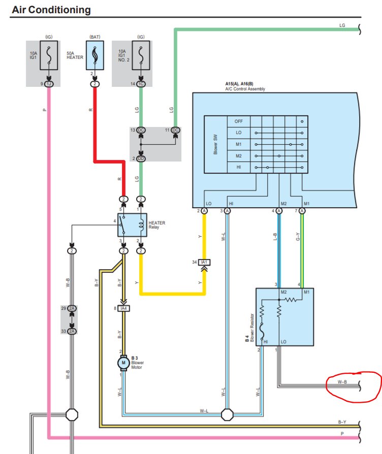

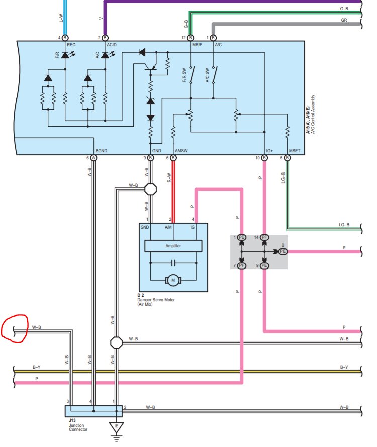

    I'll get off the can and post screenshot of the circuit

    See the top right blue box of the first pic in post 183 above https://www.tacomaworld.com/threads/our-ac-system-sucks.556361/page-10#post-18160775
    Note, Lo, Hi, M1, M2. Hi goes directly to blower motor and not through the resistor.
