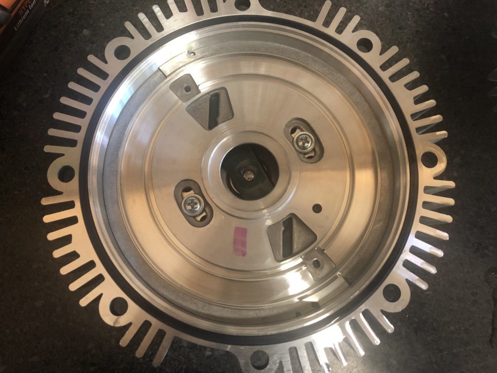

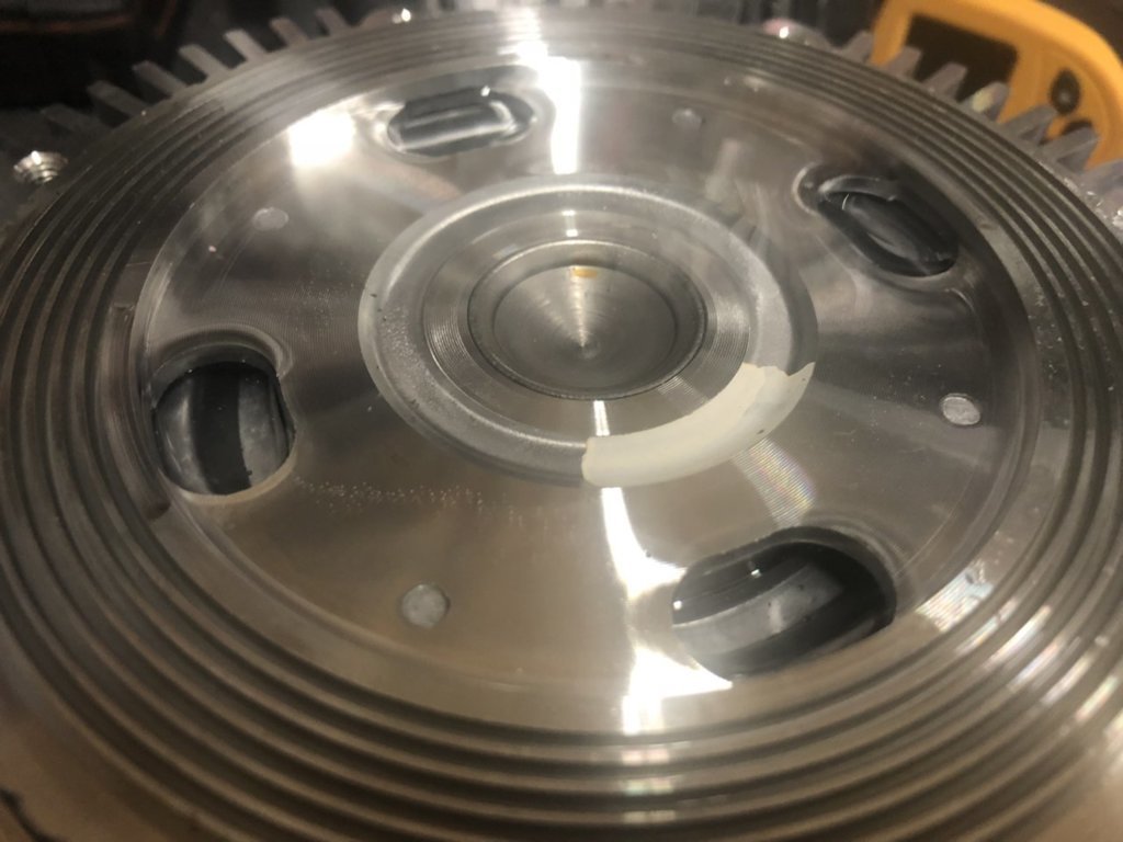

    A4652B33-C319-43FE-AF38-C3DB9884D8C8.jpg 03803702-6CDD-453F-AE39-8ED669642484.jpg
    No I dont but it's not that hard. The hardest part is making sure you get the seal back in its groove. Dont remove it if it doesnt come out on its own.
    Basic procedure is remove fan and clutch.
    Remove nuts holding fan to clutch
    Remove Phillip's screws hold clutch halves together.
    MAKE SURE YOU USE A #3 Phillip's or you may strip the screws.
    Split the clutch...super easy to do.
    Let all fluid drain into reservoir...a few hours minimum.
    Visually check the level of the fluid.
    Drain fluid...minimum a few hours.
    Refill to original amount...wait an hour minimum and refill to factory level.
    Put it back together and enjoy.
    After removing the screws keep the same orientation of the clutch. The reservoir is at the lower half and the thermostat/spring is facing up.
    There are other writeups online but are not specific to our pink clutch fan.
