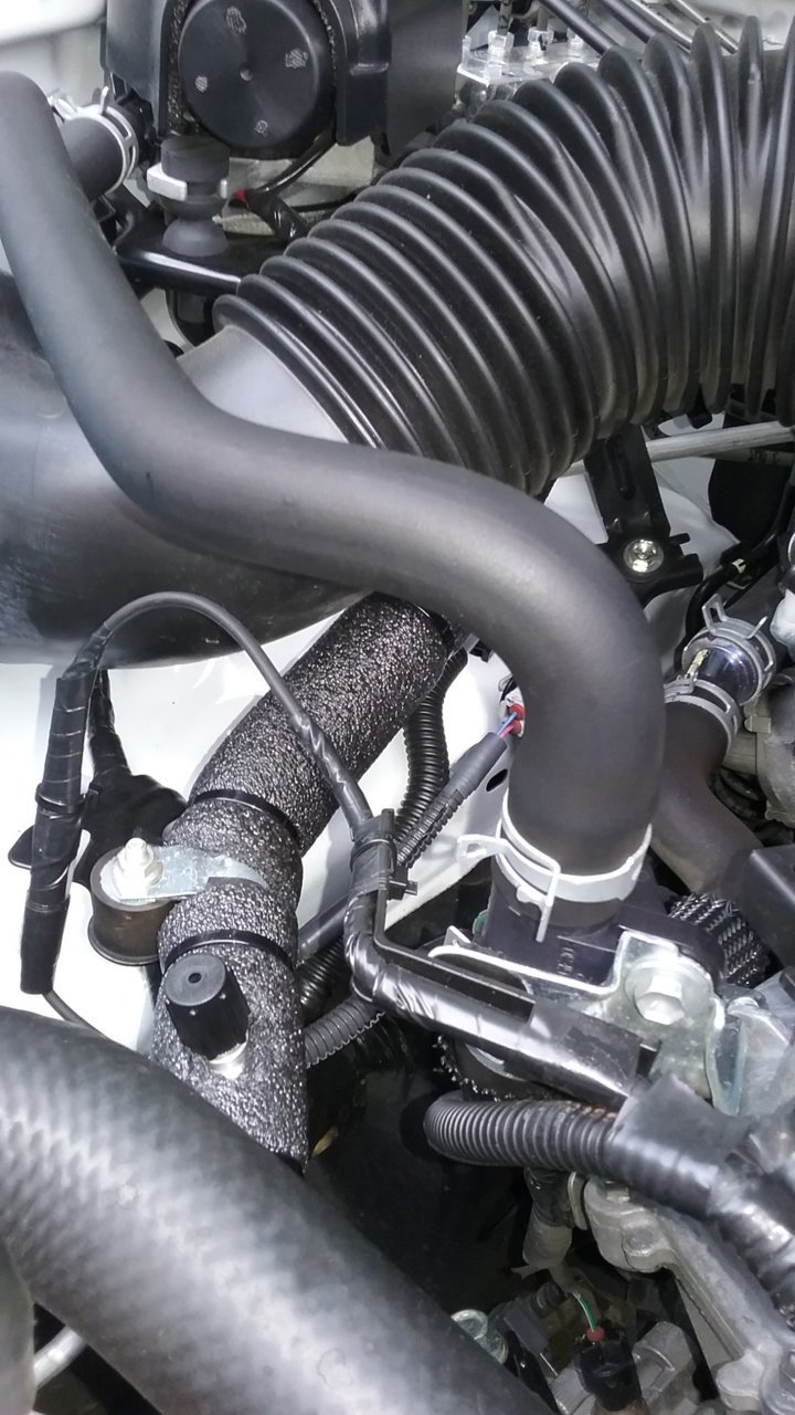

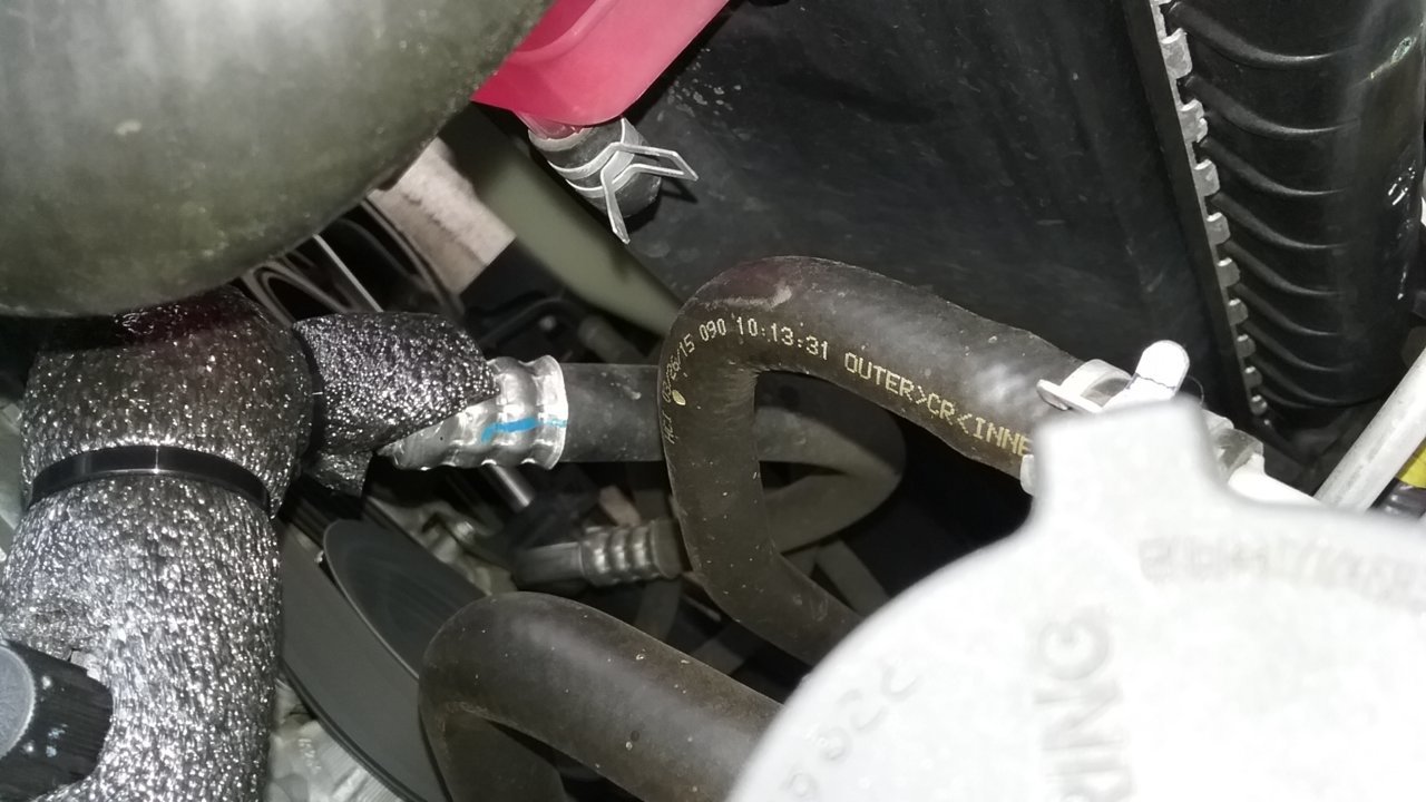

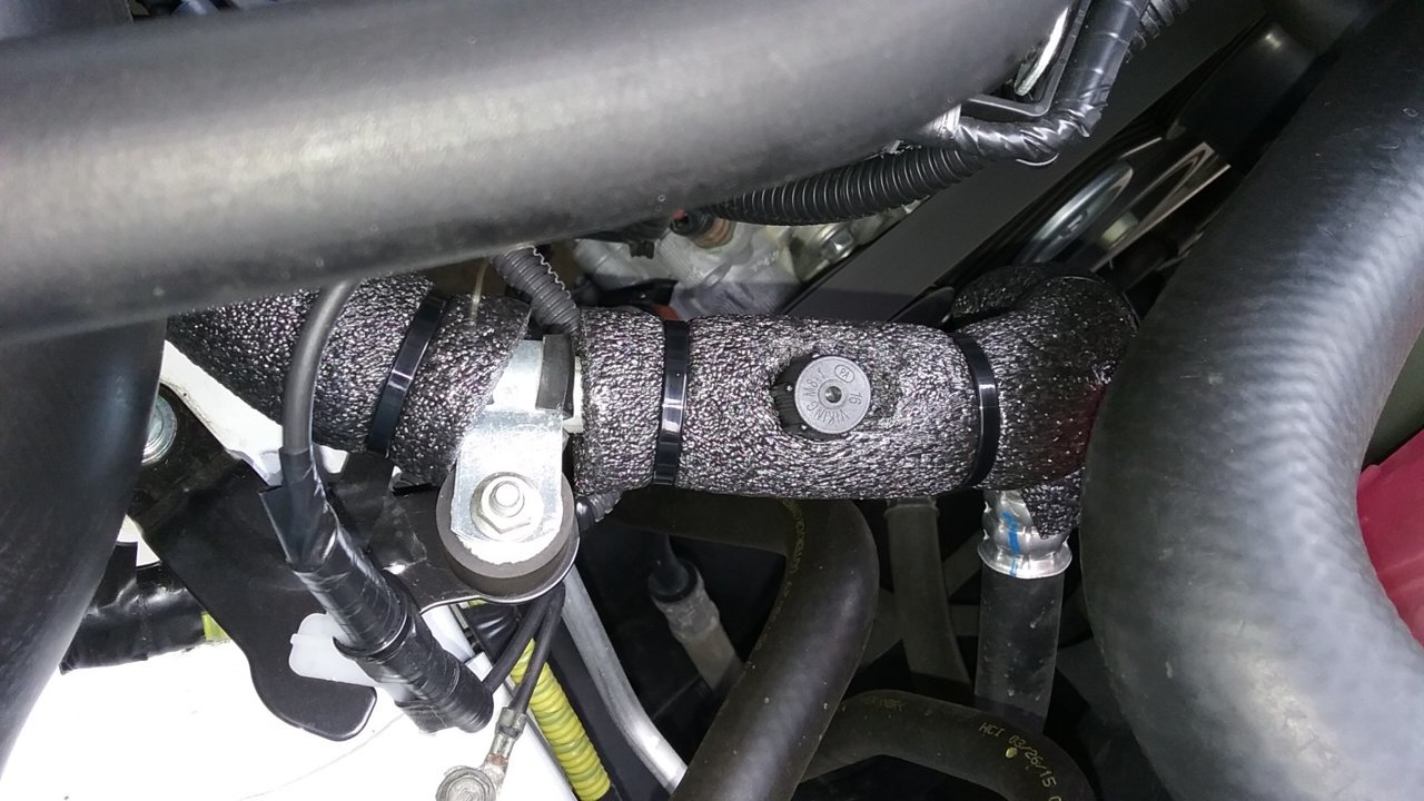

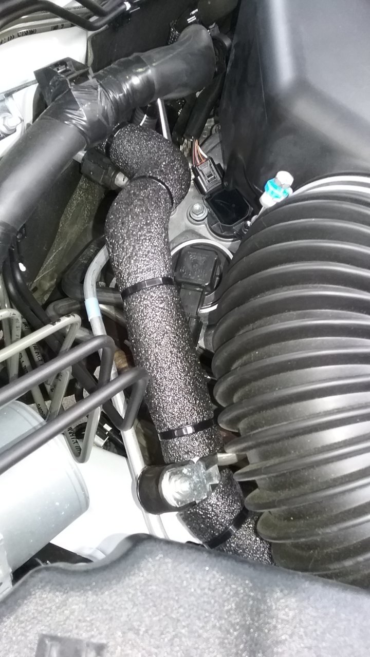

    I did that a few months ago. Pix were posted in this thread
  13. Jul 5, 2018 at 7:19 AM
    #293
    PennSilverTaco
    PennSilverTaco Encyclopedia of useless information...
    Jul 15, 2014
    #134007
    72,851
    Charlie
    Central Bucks, Pennsylvania
    2010 Zombie Truck 2002 PT Cruiser
    Have you noticed a difference?
  14. Jul 5, 2018 at 7:36 AM
    #294
    Plain Jane Taco
    Plain Jane Taco Well-Known Member
    Apr 19, 2009
    #16179
    40,279
    USA
    I never did any before or after checks and had good air before it. But 1/2 inch I.D. non sealing pipe insulation was only $1 for a 6' section. So I figured why not?
