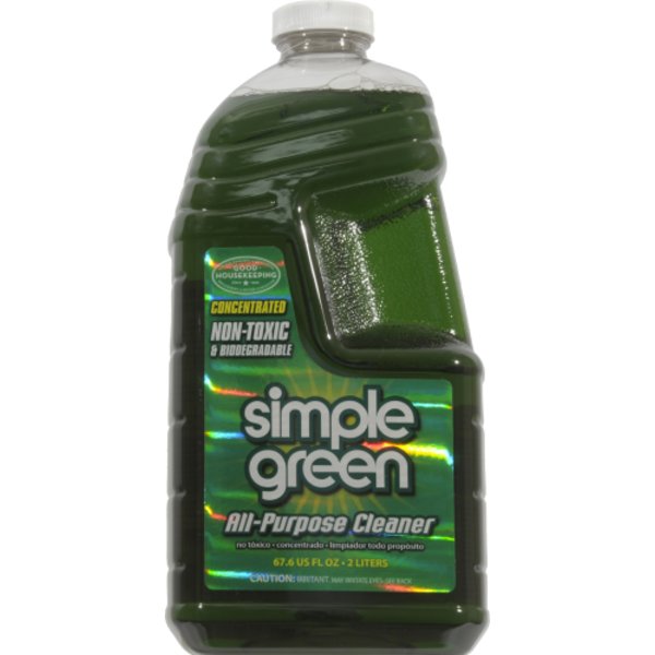

    @12TRDTacoma try idling the truck with ac on max and take a vent air temp. Then put the biggest fan you can find right in front of the grill as close as possible and check vent temps again. Keep hood closed the whole time. If your temps drop with the fan then you know you have a condenser airflow problem at idle.

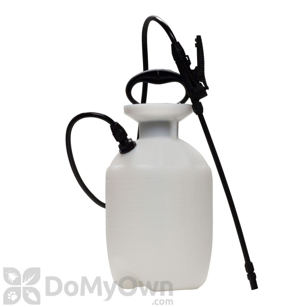

    Alright I'm going to try it this weekend. Thankfully I have a lot of simple green as I use it to remove cosmoline from my old rifles :p

    And get one of these. You can pick them up cheap at Wal-Mart, Target, Meijer, etc.
    The ones that have the shiny foil surface are the most effective.
