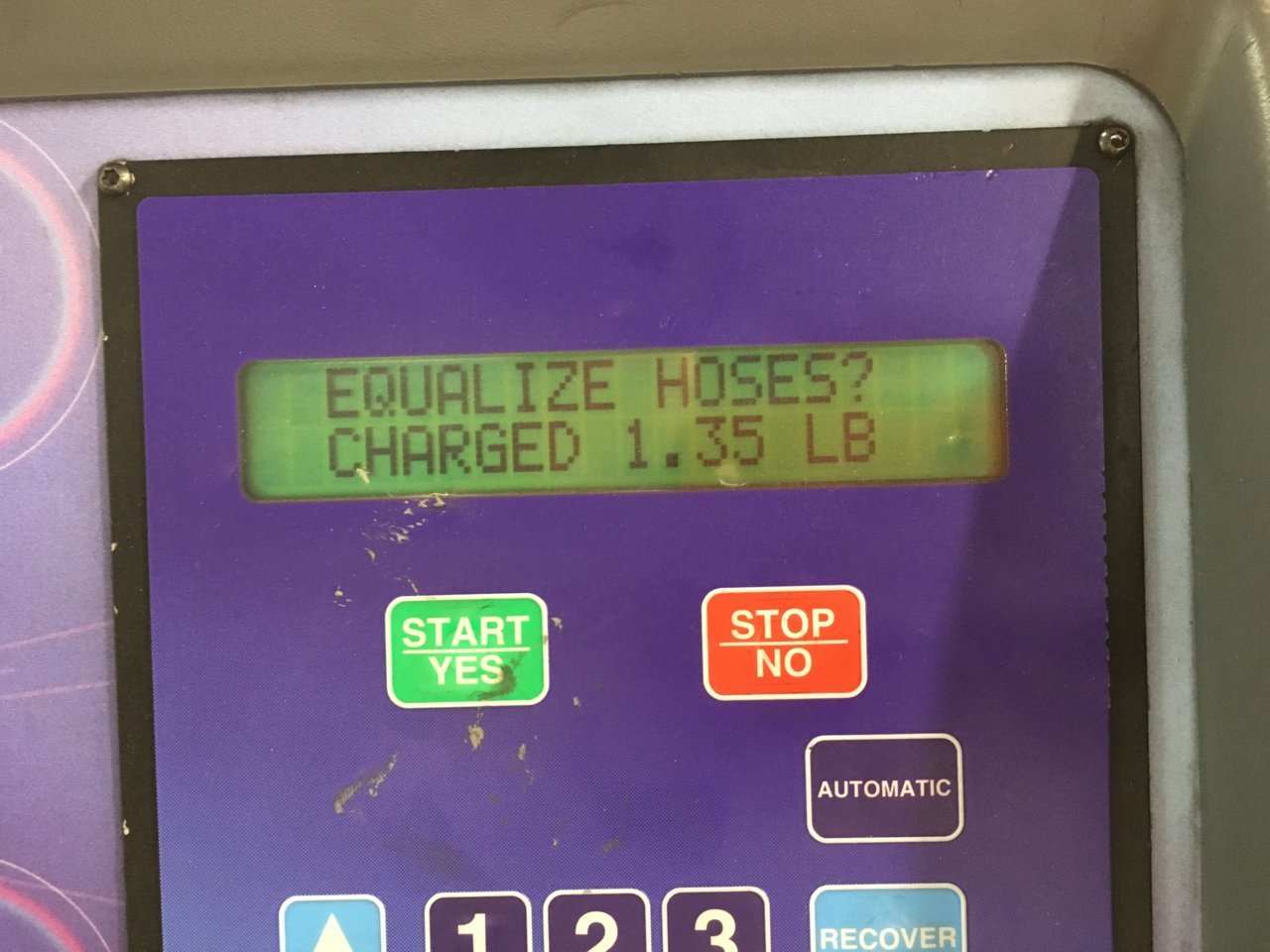

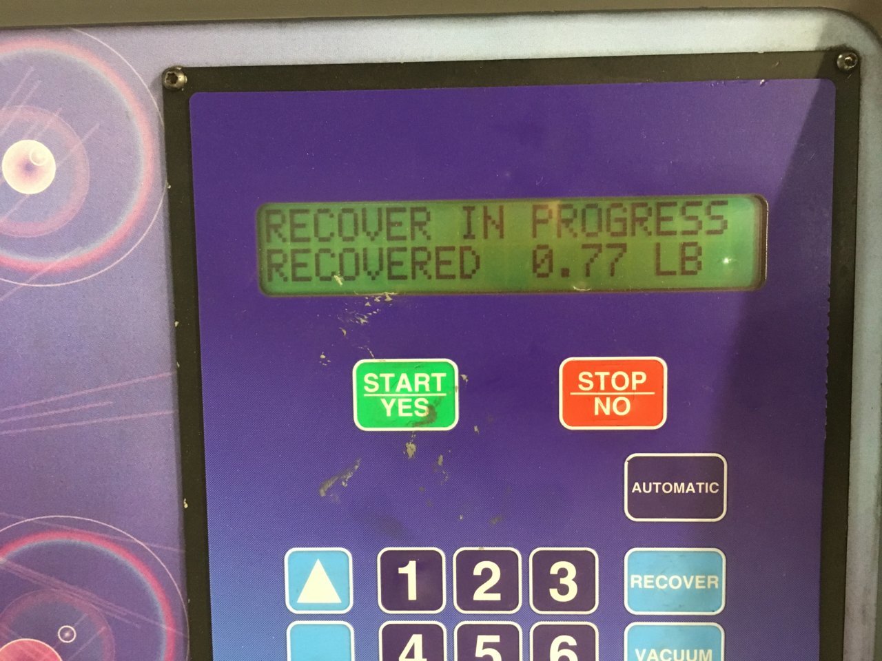

    I think I’ve found my problem. That number should be somewhere between 1.25 and 1.375 oz.

    That’s more like it.
