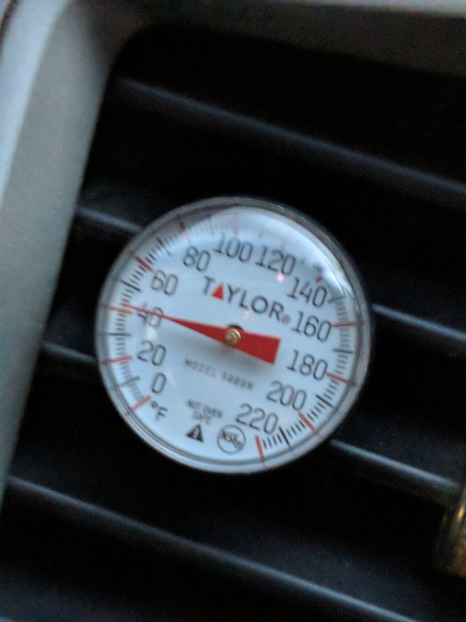

    '06 SR5 Off Road
    No context provided

    '06 SR5 Off Road
    I will take some measurments today... granted it's gonna be a cloudy cooler day..

    '06 SR5 Off Road
    Parked overnight, with current weather, idling for 2-3mins. The last show the temps with compressor engaged and disengaged. Yes it's not hot.. But that humidity makes air harder to cool. #data
