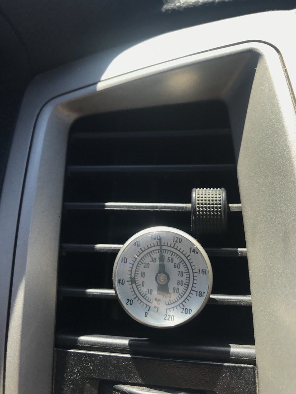

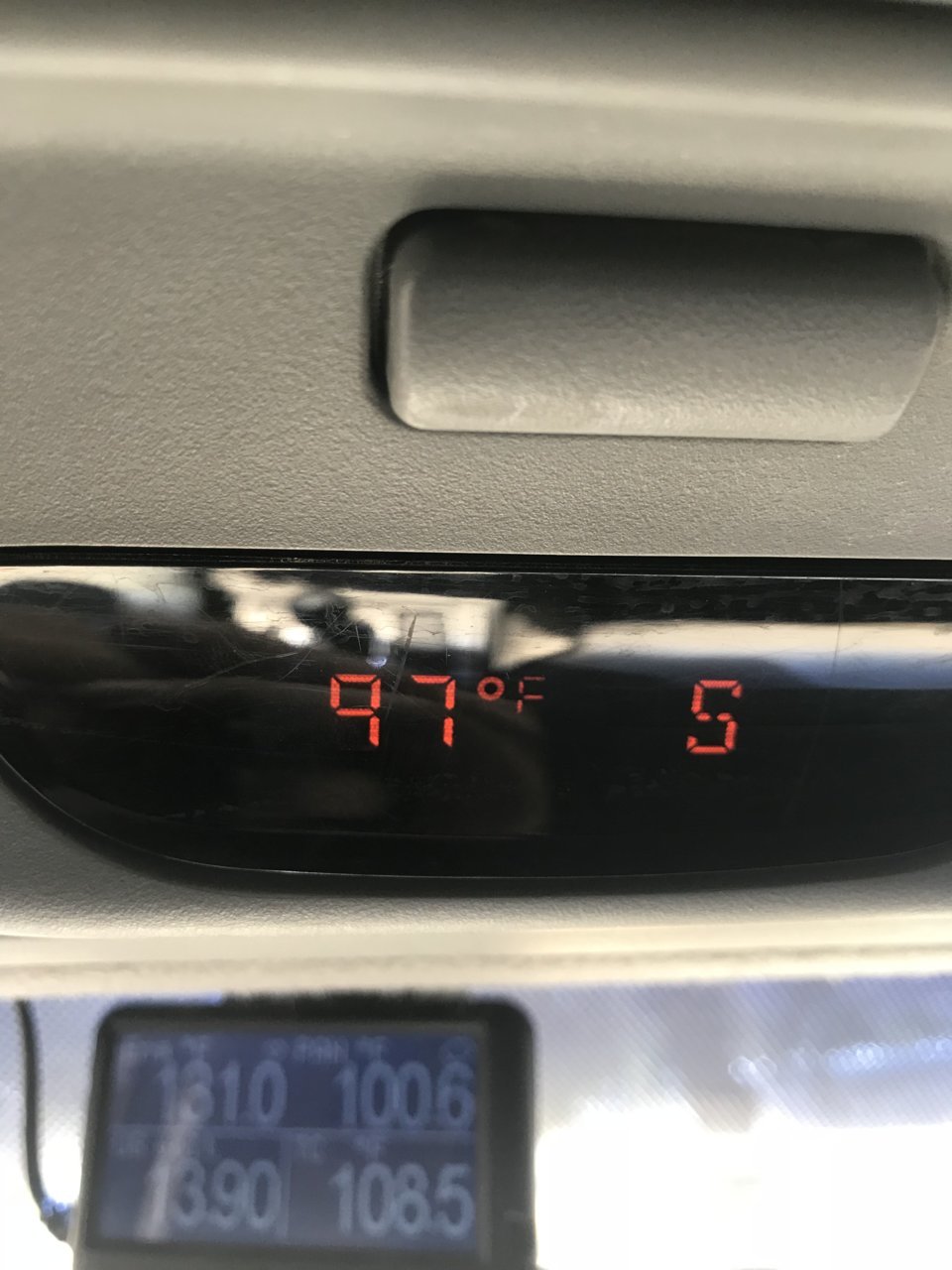

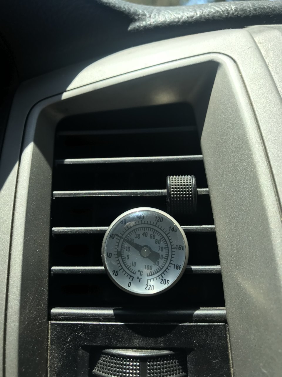

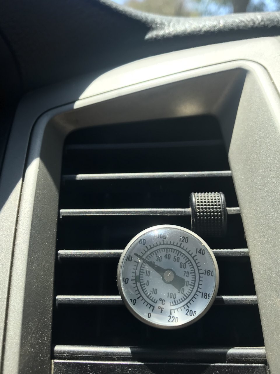

  10. Jul 23, 2018 at 12:20 PM
    #430
    anthony250f
    anthony250f Well-Known Member
    Feb 18, 2012
    #73066
    16,775
    Anthony
    San Diego, CA
    2008 dcsb trd offroad 4wd
    Here is my data....pretty poor ac performance6B9888F7-CCE2-4581-B603-DA55AEAB00D8.jpg
    The temperature before starting the truck vvvF7C41502-0A70-4102-98FC-60B62D9D40CE.jpg
    After turning the pusher fan on and idling for another 3 minutes (zero change WTF) vvvF1797934-30BD-477A-B3F3-94E00B97C188.jpg

  11. Jul 23, 2018 at 12:33 PM
    #431
    anthony250f
    Feb 18, 2012
    #73066
    16,775
    Anthony
    San Diego, CA

    Both fans

    What would cause that? It was literally just evac/vacuumed/re charged at a shop
    Or is that due to low idle rpm compared to driving ?
