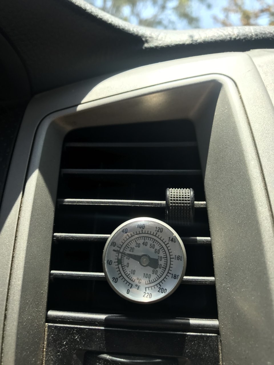

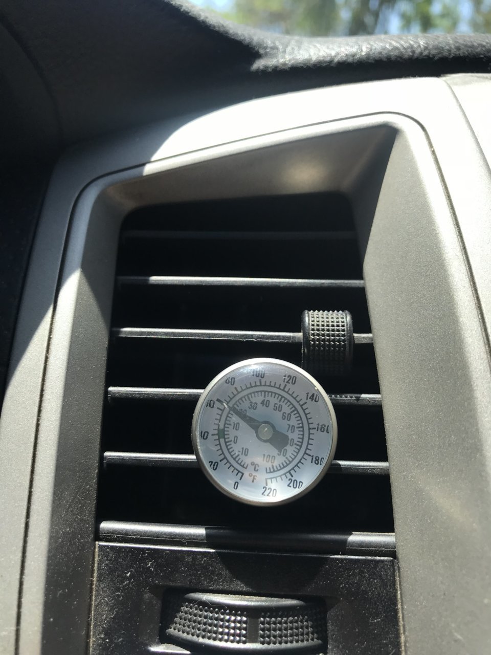

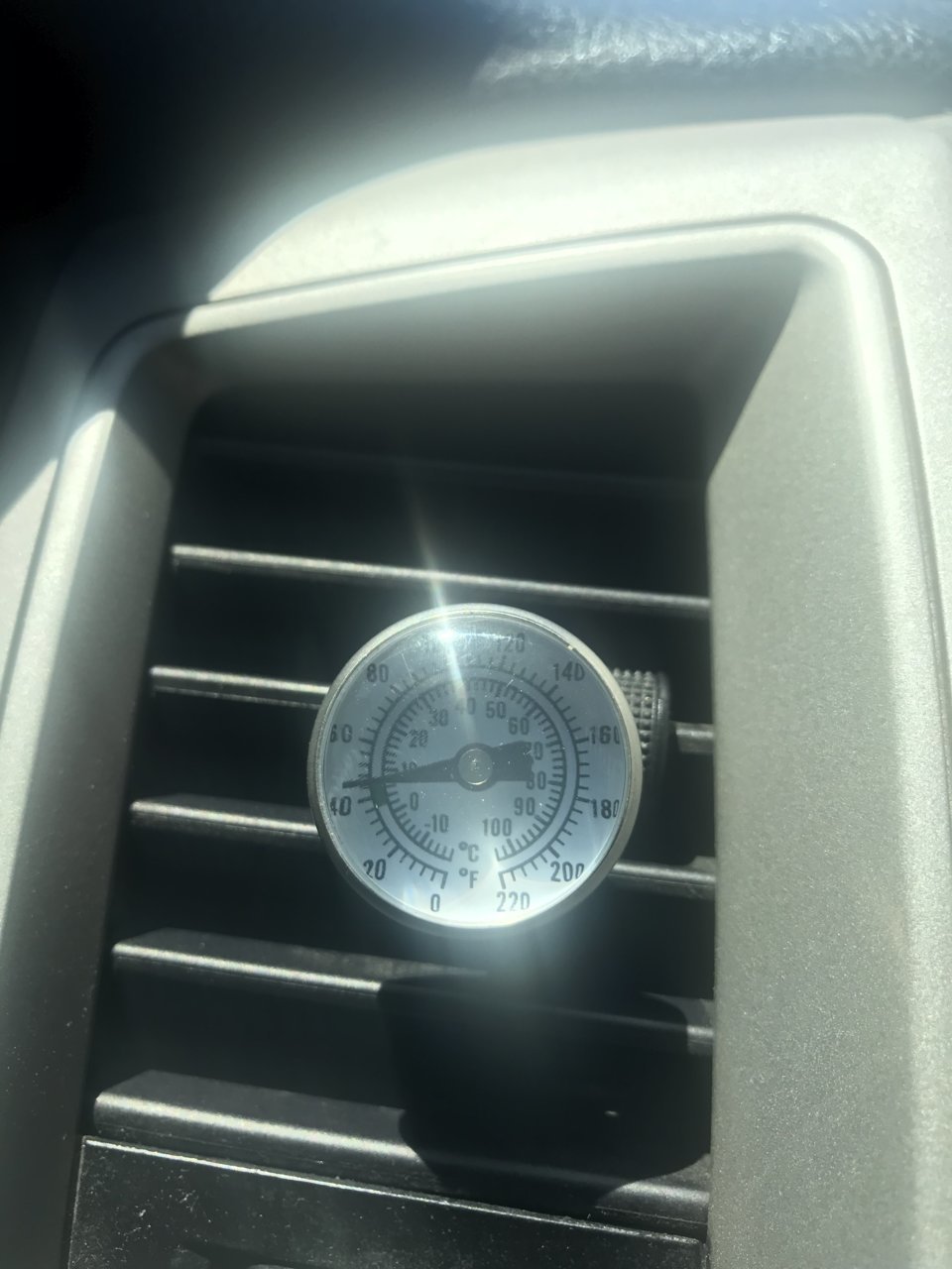

    Here’s more data WITH the fan on
    7A405546-890D-4355-A1C1-60D5F8D4D3B3.jpg After two minutes it reached this temp vvv900136BF-1433-4B44-9CF0-09447EC66A75.jpg after driving down the street vvv 590FBDBF-58BA-4153-A516-55B9B1DDE921.jpg and after idling for a few mins (e fan on)
    That’s 70* vent temp at idle in 95 degree ambient temp.
    Absolutely not acceptable IMO. 70* air felt barely cool at all. Also these fans on high blow about half the amount of air as other vehicles.

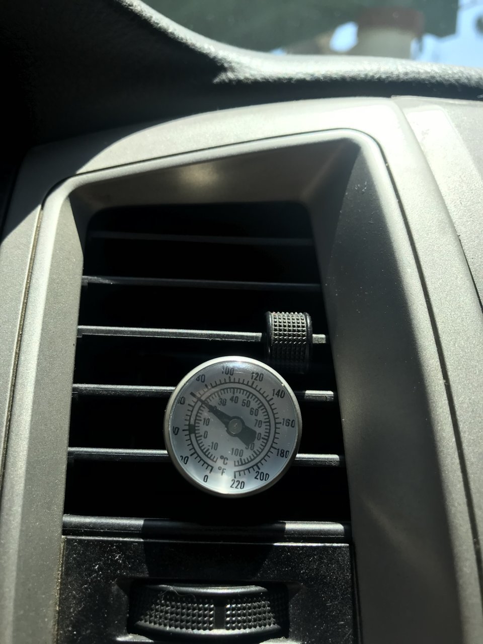

    Just tested the passenger vent...couple degrees warmer.
    Here it is after driving a steady 40-50mph
    About 44 degrees
