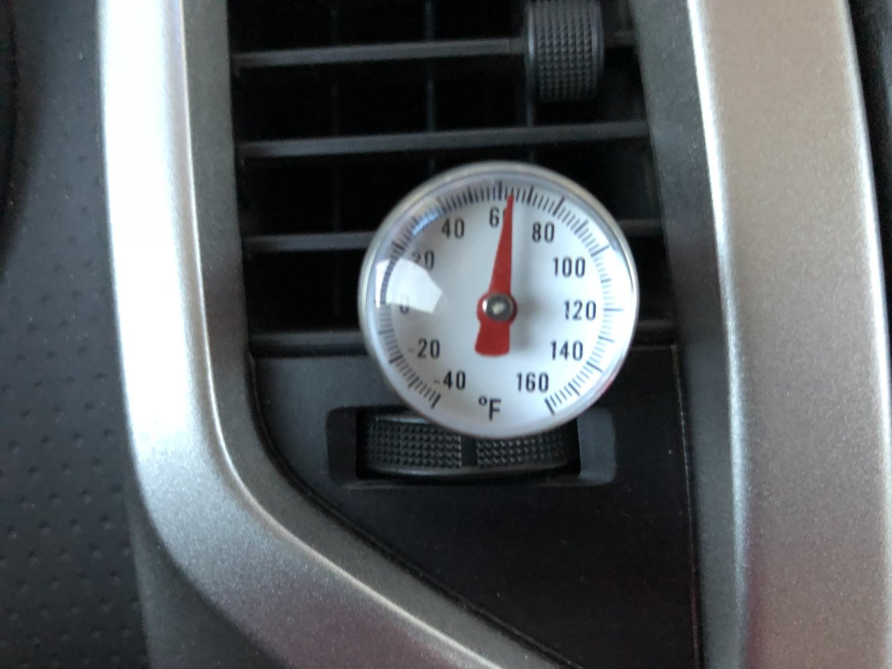

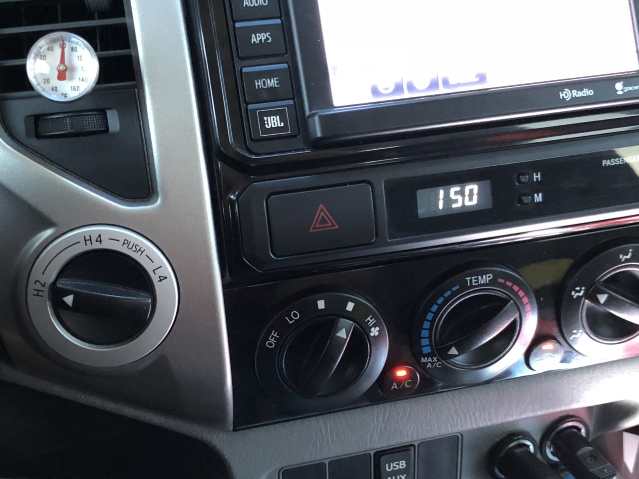

    Same settings as you
    6F1D7162-2A7D-45A2-B56B-96D49A9DD3C7.jpg Sitting at about 63 degrees
    25% humidity, feels like 102
