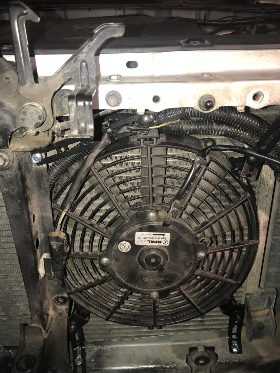

    A 10” fits pretty good. A 12 will be tight. Mine was a super cheap Amazon too lol

    My hope is the 8 inch fan will turn enough air for the A/C without blocking too much air flow. If it will quit raining I will knock it out. How did you mount your fan?

    With some aluminum stock

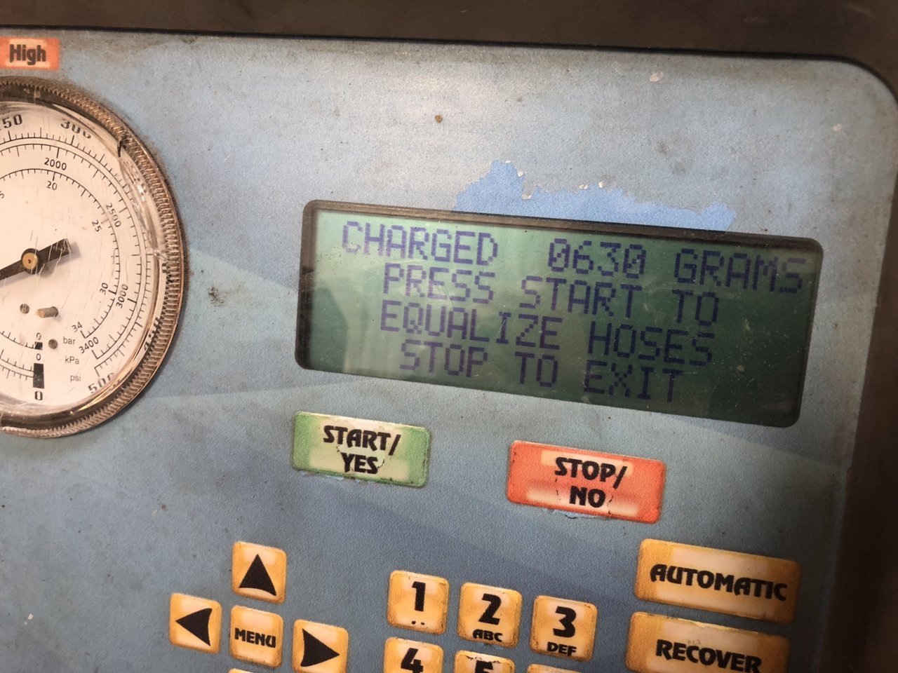

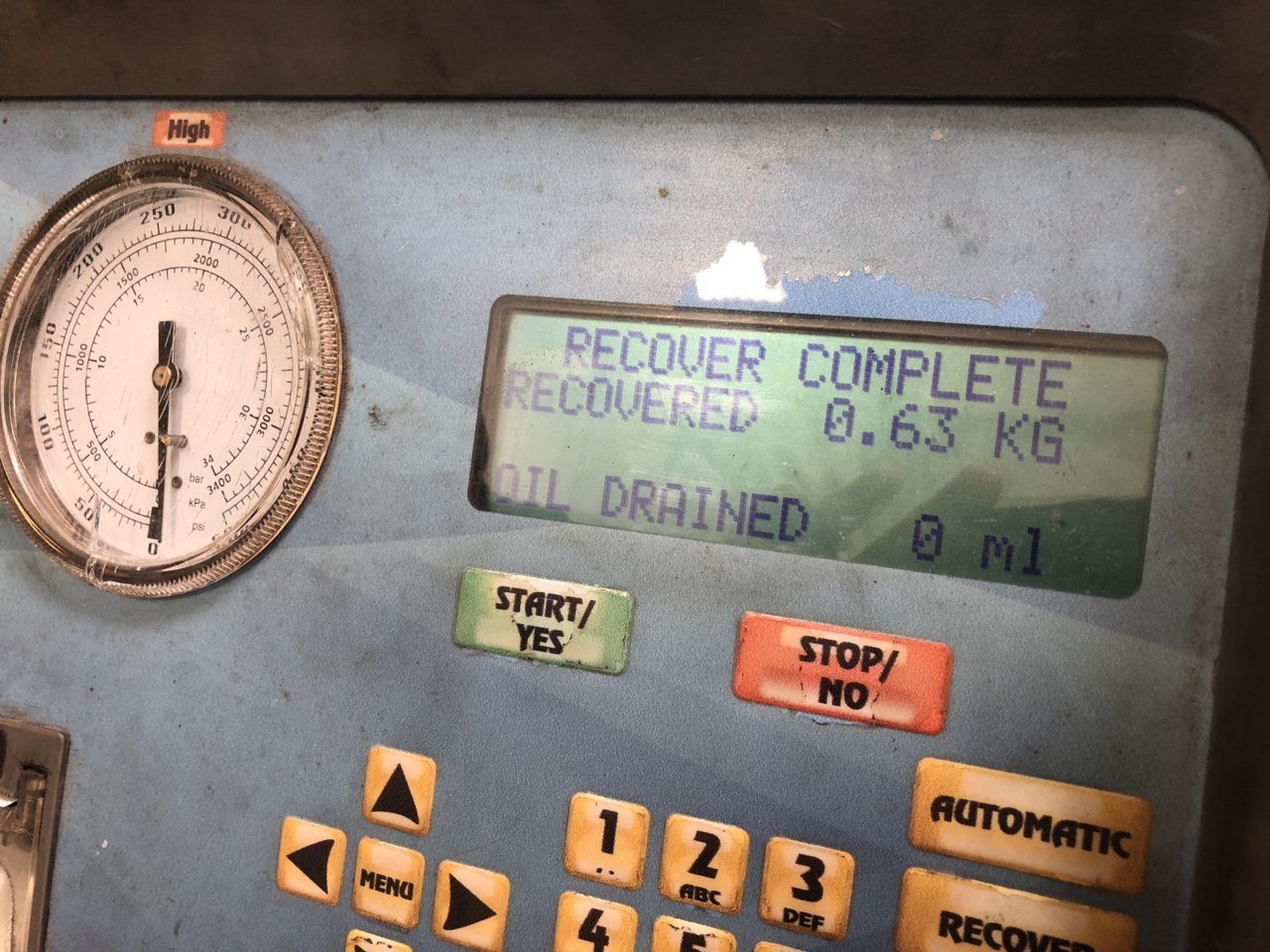

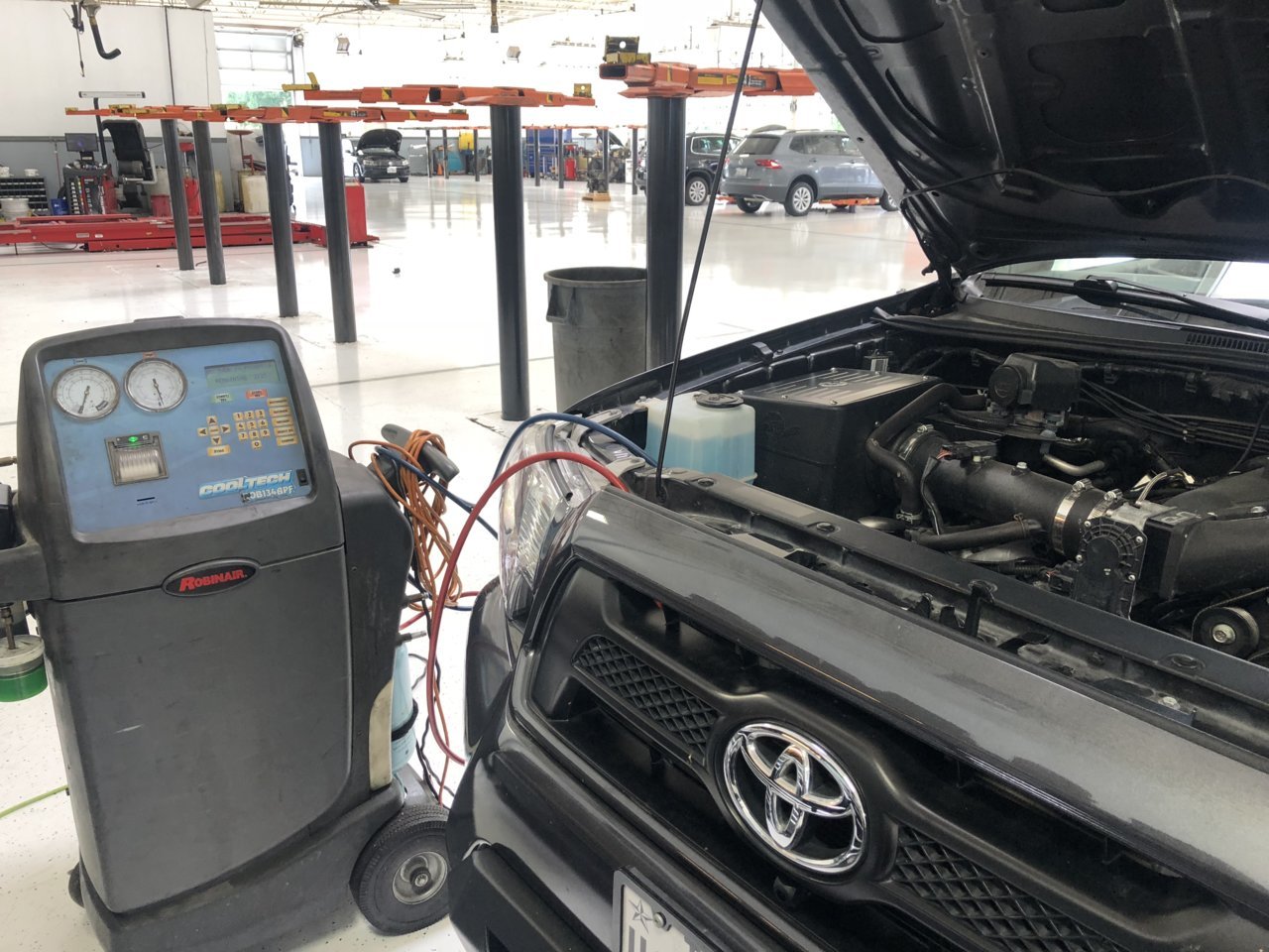

    I checked my refrigerant level today.
    Spec is 570-630 grams. This is what the machine measured for the recovery amount.
    So that’s what I put back in.

    I don’t really have any issues with my A/C. I just decided to check it, just to be sure it has the proper amount of refrigerant. No difference one way or the other.

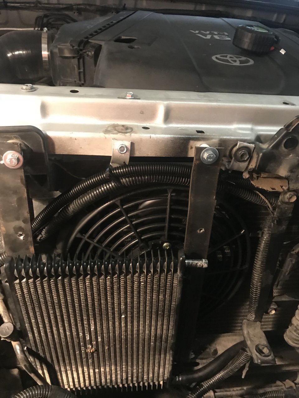

    Here’s what ive done to “improve “ airflow through the condenser. Moved the horns, made some block plates for the sides, cooling plate, and another plate that kinda directs airflow into the radiator. Also cut some of the condenser mounts off. Id like to make a piece that attaches to the top of the condenser that angles up to the radiator, and maybe order the Toyota foam pieces that go on the sides of the radiator.

    No. :annoyed: I guess its more psychological than science.

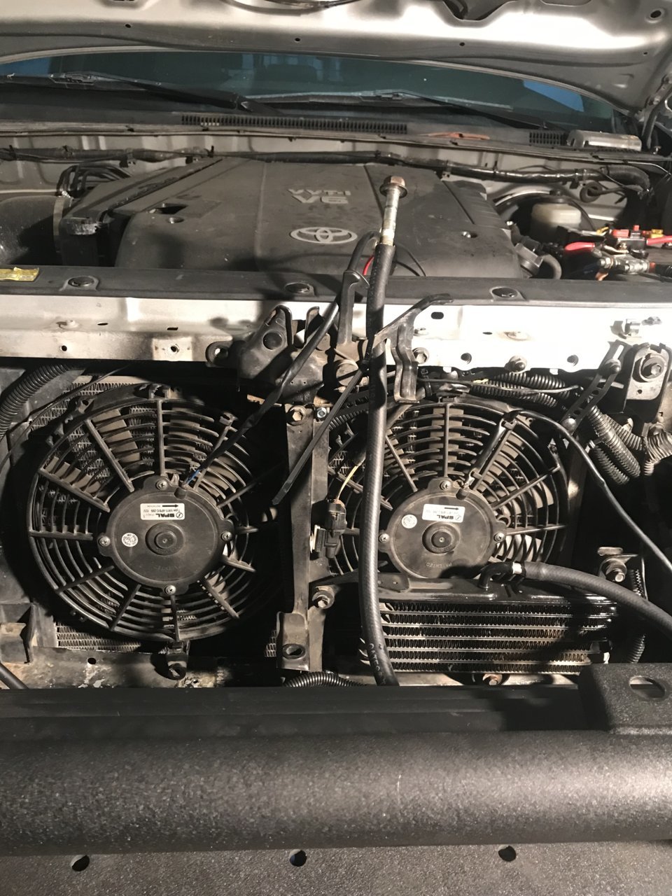

    I have my new 10 inch fan, My wiring harness is 3/4 complete and I just need to find time to remove the grill and make the mounting brackets for the fan.

    Hopefully this helps lol
