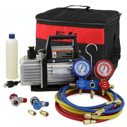

    Thankfully out of all the automotive things, I did get certified in AC (10 years ago lol).
    You pull a vacuum on the system, you suck everything out basically and any air (should really be just r134a and no air) You ensure she holds the vacuum, if not you need to find the leak. Once you verify she is solid, you dial in the CORRECT amount of oil and charge the system to the CORRECT spec. Otherwise you may blow it up.

    Don't know or care, I live in Cali, it was 104 today and my AC blows crazy cold, I'm not an AC guy so I'm not familiar with all the dynamics, all I know is 30 bucks and 5 seconds of time, bam, cold as ice

    Definitely not the proper, nor the reccomended way to charge the system.

    I am also certified. The kit in the picture I responded to does not show equipment to capture any existing freon, assuming there is still freon in the system, as is required by federal law. Existing freon is to be captured, recycled, and put back into the system after any leaks are repaired.
