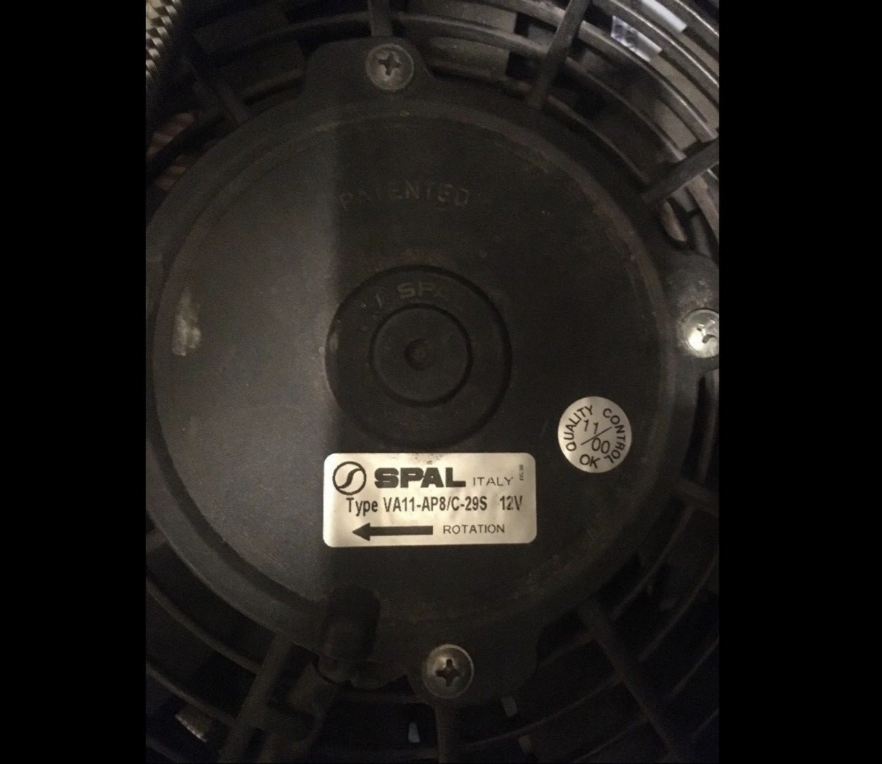

  10. Aug 28, 2018 at 4:32 PM
    #590
    TomTwo
    TomTwo I love God but I cuss a little
    Jul 14, 2013
    #108271
    14,262
    Bill
    I-85 Southbound
    2013 TRD Double Cab Sport
    Got my fan on and wired up, I will post up some numbers during the day tomorrow.DB74D193-FDBA-4596-97E6-5C98CE5A8820.jpg
    TXpro4X4 and NABeast like this.

  13. Aug 28, 2018 at 5:30 PM
    #593
    anthony250f
    anthony250f Well-Known Member
    Feb 18, 2012
    #73066
    16,786
    Anthony
    San Diego, CA
    2008 dcsb trd offroad 4wd
    Hey we are runnng the same fan! Lol
    Does your fan rotate according to the arrow ? Mine rotated opposite direction but we have the same fan part #
    TomTwo[QUOTED] likes this.
  14. Aug 28, 2018 at 5:33 PM
    #594
    TomTwo
    Jul 14, 2013
    #108271
    14,262
    Bill
    I-85 Southbound
    :thumbsup: That fan is pushing some real air I am hoping I have solved this problem.
  15. Aug 28, 2018 at 5:35 PM
    #595
    anthony250f
    Feb 18, 2012
    #73066
    16,786
    Anthony
    San Diego, CA
    I just edited my post
  16. Aug 28, 2018 at 5:40 PM
    #596
    anthony250f
    Feb 18, 2012
    #73066
    16,786
    Anthony
    San Diego, CA
    Same fan part # yet they spin opposite directions :confused:
    TomTwo likes this.
  17. Aug 28, 2018 at 5:44 PM
    #597
    TomTwo
    Jul 14, 2013
    #108271
    14,262
    Bill
    I-85 Southbound
    @anthony250f I noticed that. I drove down to Summit Racing here in Atlanta and made sure I got a "pusher" fan. I hooked it up to my battery real quick out in the parking lot to make sure it did what I wanted it to do before I drove all the way back home.

  19. Aug 28, 2018 at 5:47 PM
    #599
    anthony250f
    Feb 18, 2012
    #73066
    16,786
    Anthony
    San Diego, CA
    Yeah looks like our blades are facing different directions. Mines def a pusher too but spins oppisite. I did two up front, they are pretty noisy. They push a ton more air with the truck running.
  20. Aug 28, 2018 at 5:49 PM
    #600
    TomTwo
    Jul 14, 2013
    #108271
    14,262
    Bill
    I-85 Southbound
    How long have you had them on your truck? Did you remove the factory fan? and just go full electric?
