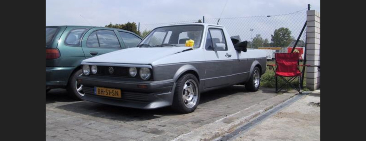

    Need some hood spacers.
  8. Sep 7, 2018 at 5:37 PM
    #648
    12TRDTacoma
    12TRDTacoma [OP] Powered by Ford, GM, VW, and Mercedes
    Aug 20, 2012
    #85133
    16,683
    Rob
    Concordia
    12 TRD Sport DCLB 4x4 Supercharged
    Boosted
    Eh? For the back you mean? Lol.
