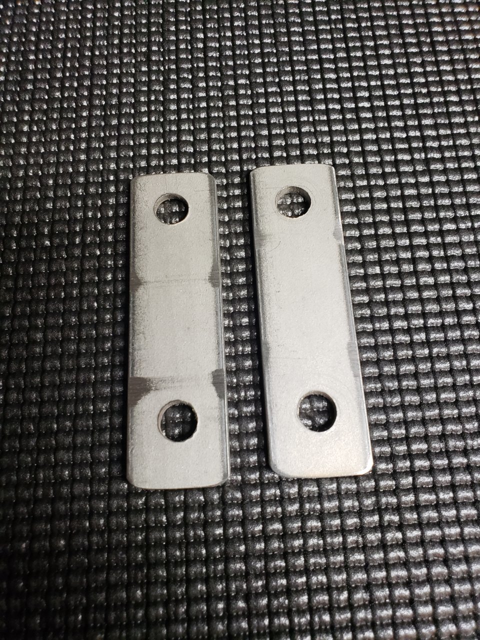

    Hood spacer shims. Freshly made.
    They are only 1/8" thick. I dont want a big hood gap on the sides of the hood.
    12TRDTacoma[OP] and loginfailed like this.

    I think I’ll put the seal back in so water runs off to the sides instead of straight into the bay. Then space the hood up so air can still get escape.
    I want to see them on. I’m thinking I want to go thicker. Because racetruck.
