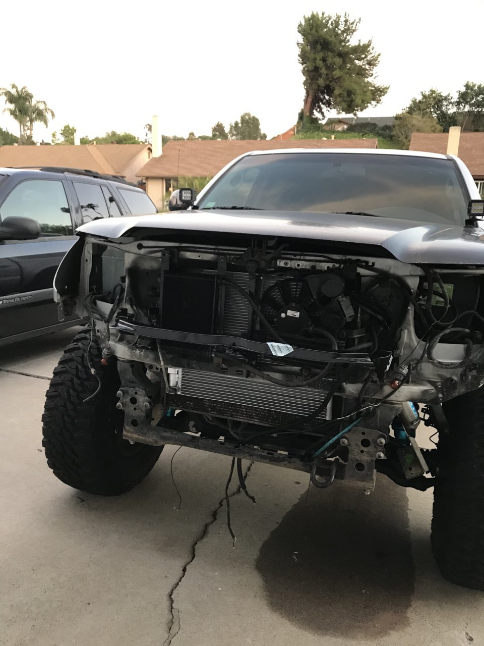

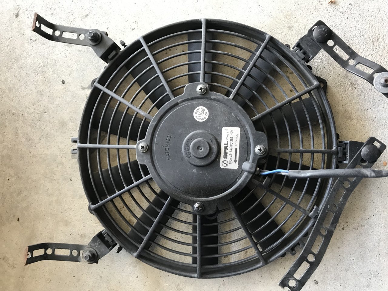

    If anyone wants to get a fan I’m selling one.
    Mounts to the passenger side. High quality SPAL fan

    Why are you getting rid of it, it seems you have been down this road with a supercharged set up, I'm curious where you are going next

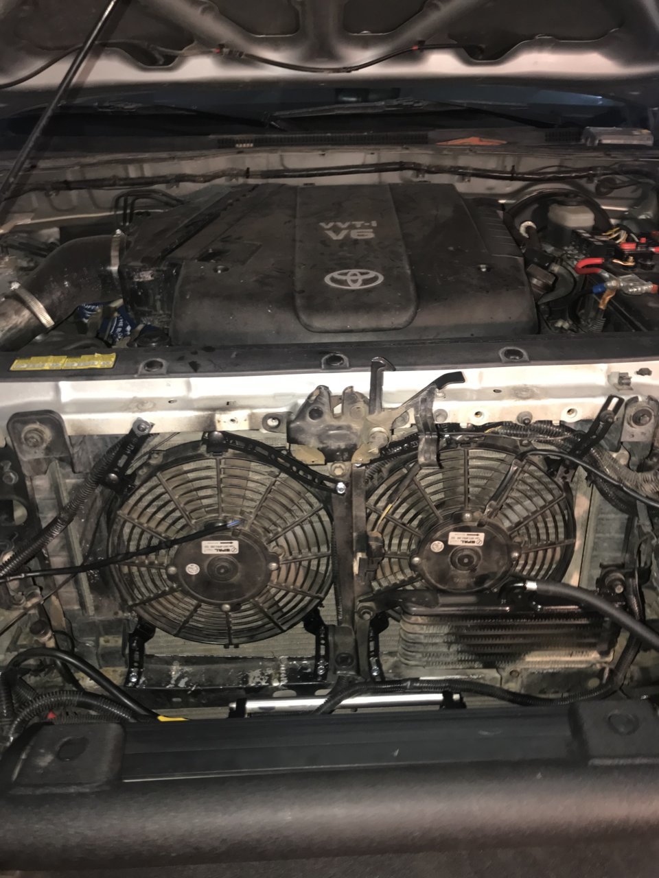

    I’m going with one fan. Two covered the entire front end and I had too much blocking the natural air flow
    I just put a new condenser in. Recharging soon. Praying I have temps under 50 lol
    Otherwise I’m gonna have to do that resister if it isn’t too difficult

    I'm wondering if I can place this fan on the centerline. It is pretty thin, will see.

    The centerline? It’s the thinnest fan available. It fits behind my OEM trans cooler
