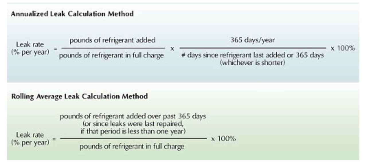

    There is calculated allowable refrigerant leakage.
    12TRDTacoma[OP] likes this.

    It's true. Systems go low as HVAC systems have an allowable leakage rate.
    This is why it is advised to perform an AC service on them once a year in the automotive industry. To make sure you are topped off to the correct amount of refrigerant and not making taxing the compressor due to low levels.
