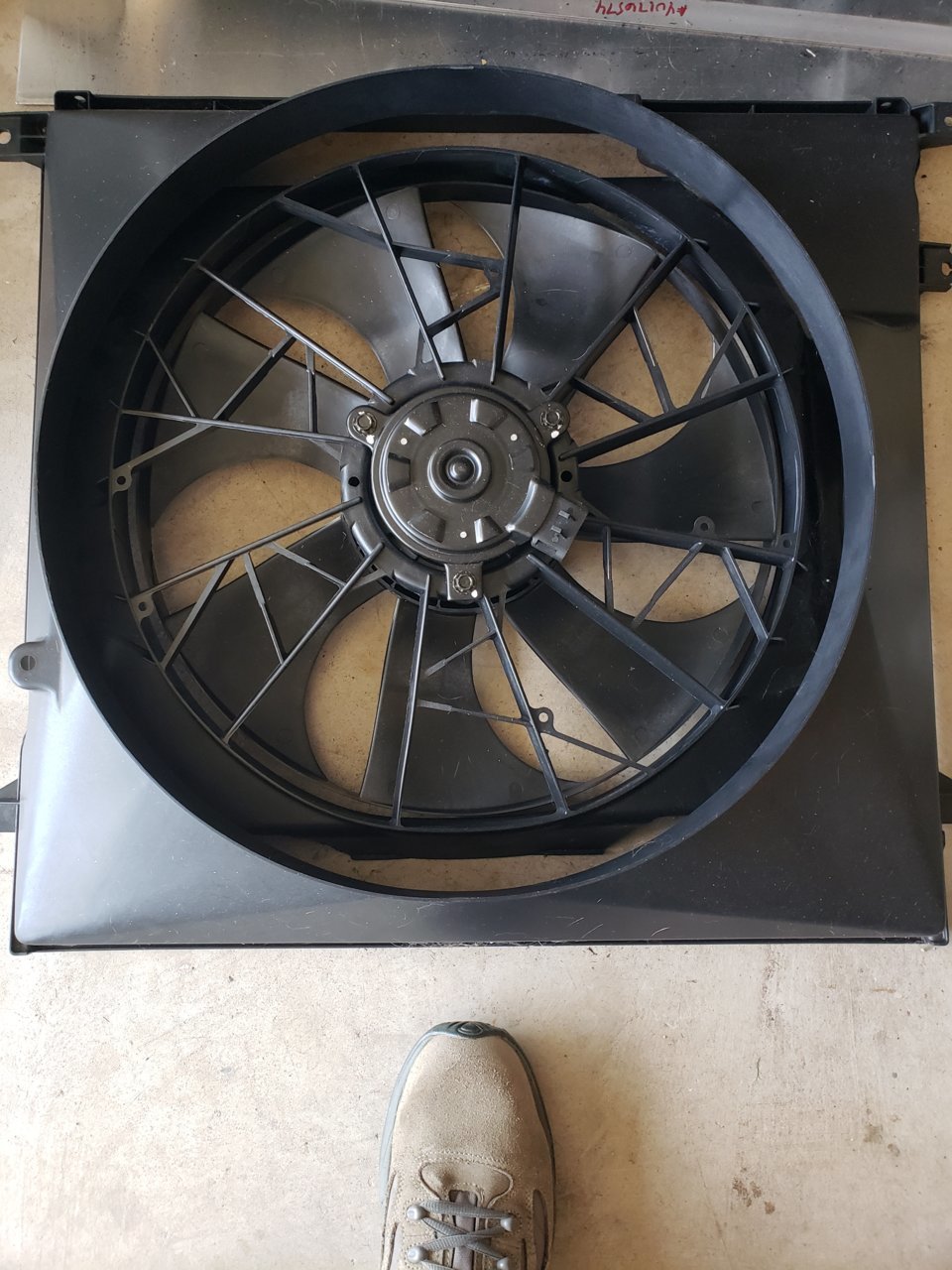

    04044 motor and 04050 will not easily interchange. I had both in my hands at the same time this week. The 04050 motor is trash anyway. Currently they are back ordering like crazy because they are failing like crazy.

    The new pressure switch (Mexico spec) switch simply adds a circuit to trigger the new fan relay.

    Can you elaborate on this? Is it because of the size of the blower or is it the plugs that are massively different? I figured there was issues with it as I’ve seen a lot of threads from 3rd gens who had theirs nuke itself.

    Fan only needs modifications if the truck has a trans cooler (tow pkg). The fan is an OE part borrowed from Mexico spec tacos (pun intended). All by itself it’s like $450. That is the bulk of the expense of the kit mentioned in the TSB.

    The mounting tabs are different. I’ll have to grab some pics later this week. Connector is no problem tho. Even if it is different, it can be had.
    But like I said, the 16+ motor (04050) is seriously garbage. Wait for an updated part number before you try to swap. 04051 will likely be the next iteration. The earlier 04040 motor superseded four times to the current 04044. They were problematic as well.
