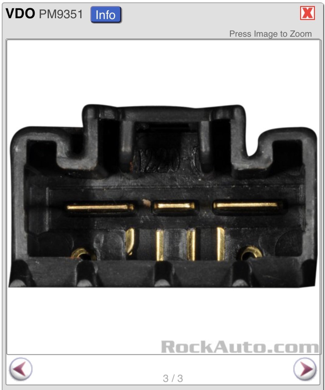

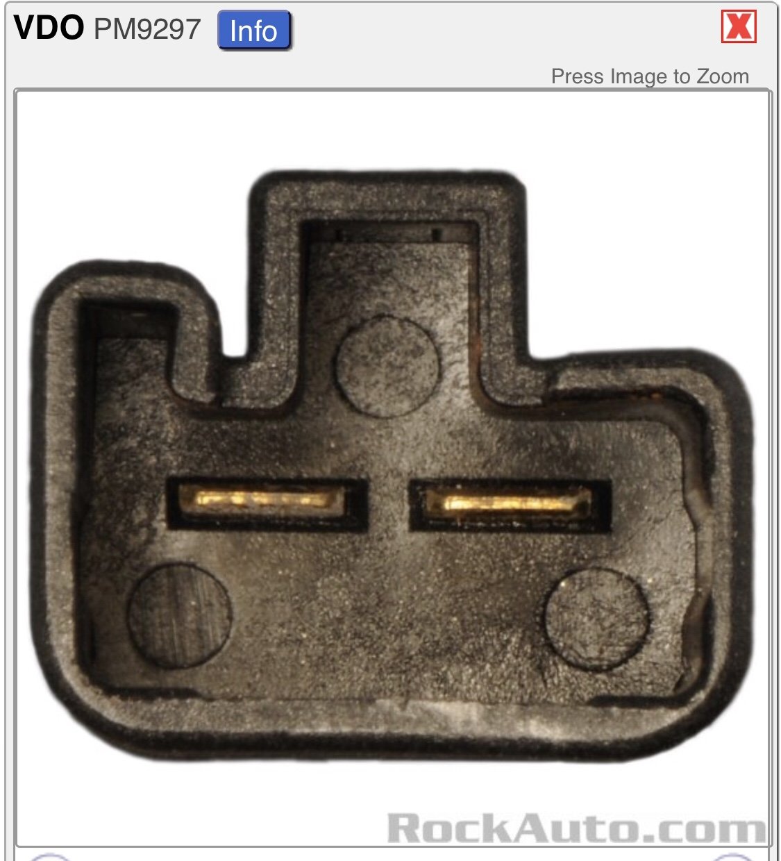

    Upon inspection of the diagram, what I have found is the usual suspects, power and ground exist at the plug for a 2008 Toyota Tundra, but the center pin wire at the connector connects directly to the AC amplifier which in their case is actually the digital HVAC unit. Inside of the unit, it uses its own built in resistor which will likely send the fan the proper voltage regulation it needs based on speed.
    If we are able to utilize a blower from a Tundra, Avalon, or even Sequoia, and the fan physically fits ours properly, I don't see a reason why we can't turn the third pin into a dummy and utilize our current resistored power and ground setup.

    This is good news. I will see if I can get my hands on one of the blower motors. Sienna/Sequoia are for sure the biggest. I think tgey may be physically too big. But the avalon/camry/venza/tundra are all the same. So there is a possibility we could make it work maybe. I’ll let you know what I find out.

    Yeah keep me updated and If they are the same bolt pattern I'll get to work on my own as the guinea pig!

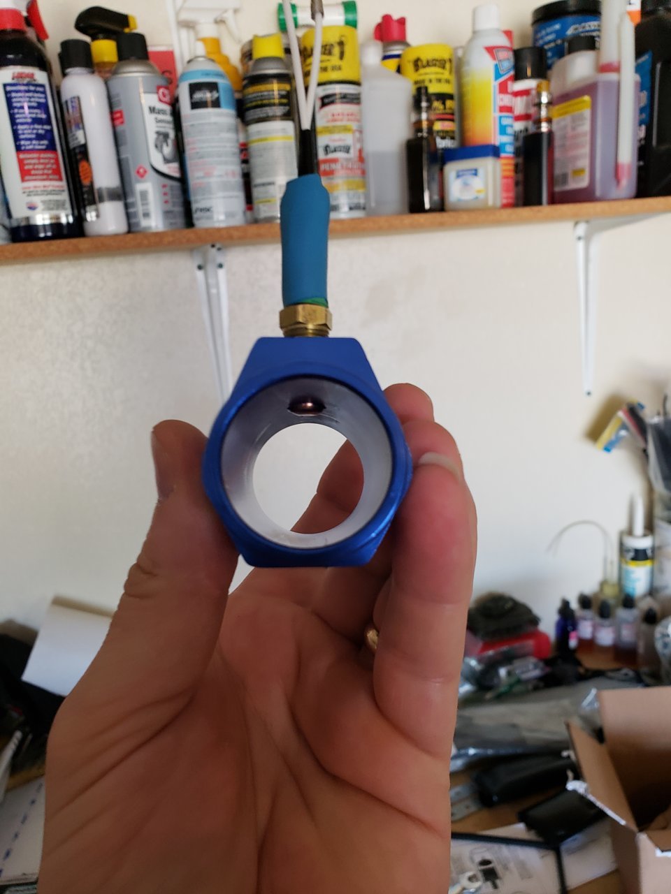

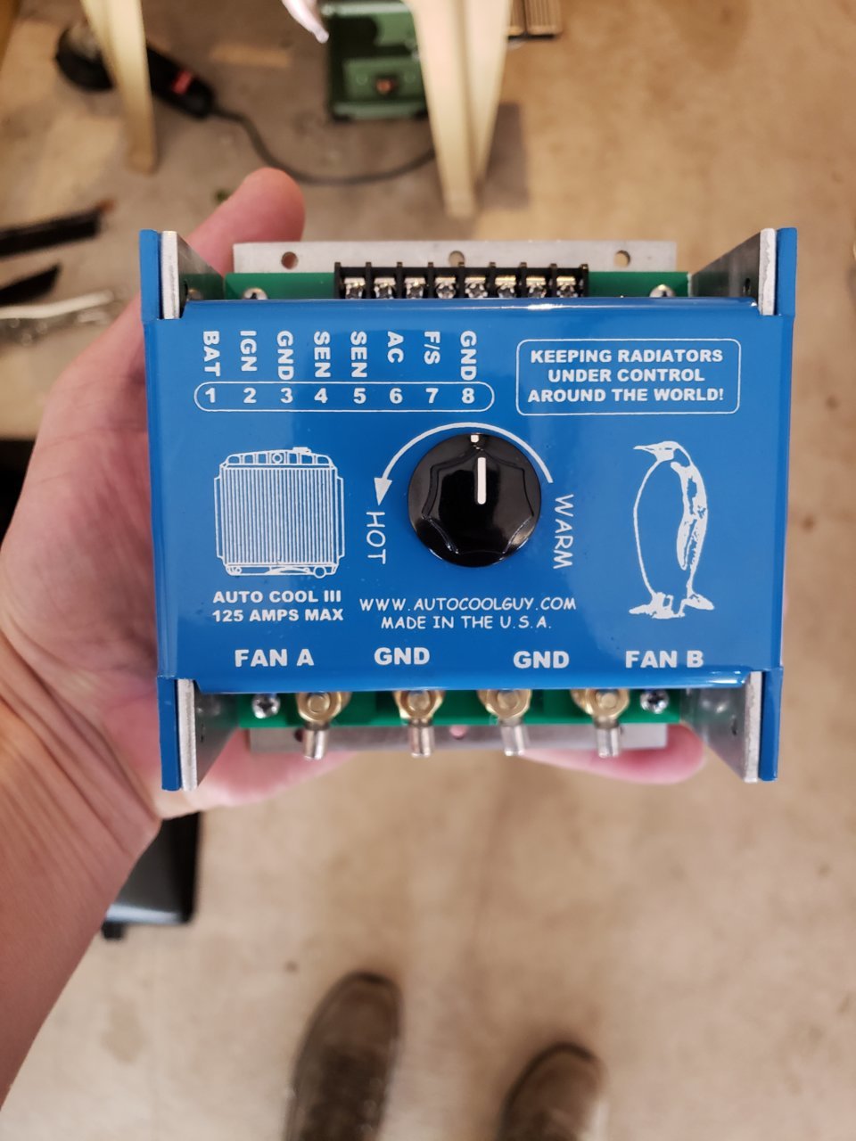

    @12TRDTacoma I totally agree with what seems to be shotty reliability of electric fan controllers. I also wanted a pwm style controller which is why I got the one I did. I also agree about clutch fan reliability. It becomes less effective over time because of the oil viscosity loss but still will almost always work somewhat unless all the oil leaks out.
    With electric obviously there are more parts AND the whole controller reliability factor. This is the one I went with.

    It's pretty stout internally and not digital so hopefully I never have a problem with it.
    This is the temperature probe.
    So you can adjust the speed of the fan for whatever your a/c system requires but the engine cooling needs will override control to keep the engine cool if required.
    It is a soft start system meaning voltage will start slow preventing huge amp draws when the fan starts. Important considering the fan I'm using draws around 40 amps at full load.
    The big thing with these pwm type controllers is that the fan should never even be close to max rpm. It rises and lowers to controll radiator outlet temps.

    Where does that probe attach? The AC low side line on the metallic part? That looks like quite a nice controller. Where do you intend on mounting it, interior or exterior?
    I actually have my beliefs that perhaps these PWM fan controller are failing perhaps due to extreme engine underhood temps rather than poor electronics. If that can be run in the interior than we may be in a better position as a whole.
