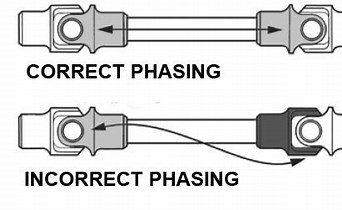

    The phase of a drive shaft is not relevant to the transfer or differential flanges. I am not sure about your "marks". What do they represent? Do you have pictures?
    I have included a picture and YouTube link which will hopefully help.

    What Mr Hobbs said.
    From your other thread, you changed the support brg. When that flange came off it went back on 1 spline off. I'll bet @cruiserguy 's life ;) it's just one spline.
    Countless folks think the drive shaft end flanges have to mate to the diff and xfercase flanges exactly the way they came off. It's just not so. It's not a bad idea for other reasons and a common practice but not a requirement for any phasing relationship.
    Pull the flange at the support brg and put it back inline.
    There is a good chance you will not feel a difference.
