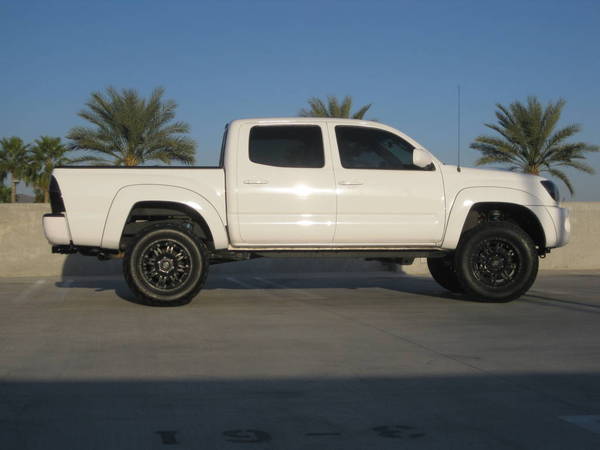

    So here's the deal, I currently have a Revtek 3" coil spacer with 1.5" rear blocks that I am soon removing and replacing with Eibach 1.6" coils and 5100's all around :D. I already have the TSB leaf springs so I do not plan on doing an AAL. Later on I will also be getting new UCA's as well (haven't started my research here, but open to hear suggestions). I have been searching for a couple months and decided this would be the ideal lift for me, so you can see I am pretty determined on getting this setup. I plan on setting the front Bilsteins at the 0.85" setting to net me around 2.5" of lift in the front matched with the TSB rear springs. What I am looking for is a level stance. Can anyone can verify this will sit level? I really would rather not have it be nose high unless I was actually long travel. So please, if anybody has this setup or something similar and can verify this please chime in.
    With my current setup the rear sits a bit higher, the front has sagged a bit since this photo is out dated but the TSB springs are settled in the pic. Just giving a general idea of how it sits now.

    I have had the TSB springs done for awhile now, so I am sure they are done settling. As of now the truck sits higher in the rear, but I am thinking it will be a bit more balanced once I pull out the blocks. It looks like the front coils have sagged since installing the lift. All this makes it a bit more complicated, I will add a recent picture of how it sits now to my OP.
