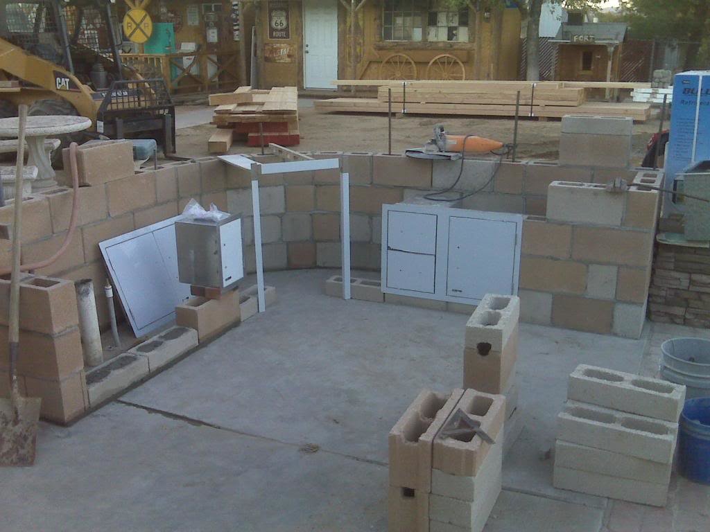

    So I didn't make as much progress as I wanted. I had a mismeasurement that set me back about an hour. Nonetheless, I got the grill mount near finished. The grill slides right in between the two side supports.
    I'll fully weld the grill support tomorrow. Now I need to pick out a mini fridge and a drawer/cabinet combo so I can finish the frame.
    first shot of the grill going in
    from behind

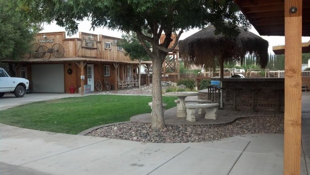

    It reminds me of my dads somewhat, but he built his with brick
    Then put a 4.5 or 5 inch concrete slab for the bar area
    With the matching fire pit. This is the only picture I have of it finished.

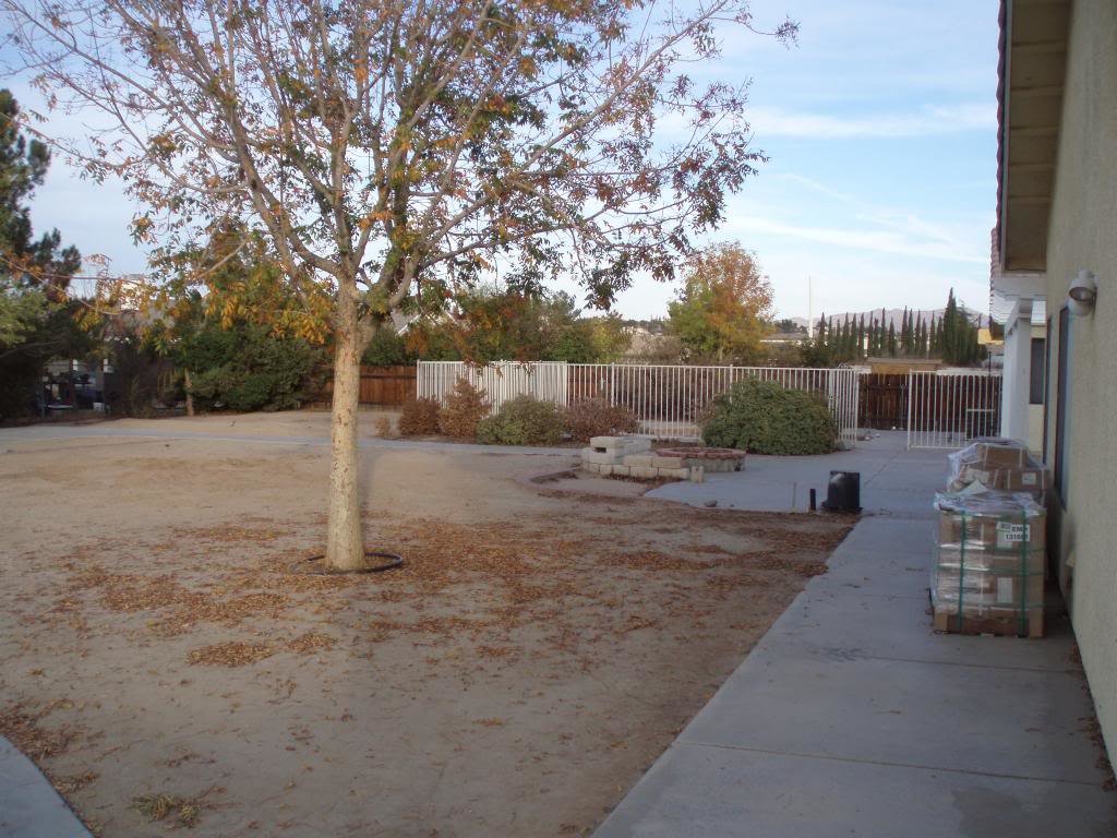

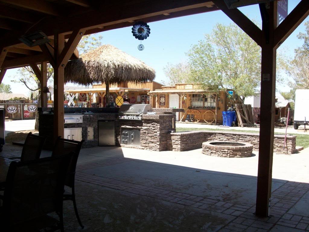

    Thanks! Just be careful, once you start doing things to your house you won't be able to stop like my dad haha.
    The backyard when we moved in the house in 2007
    As of this year

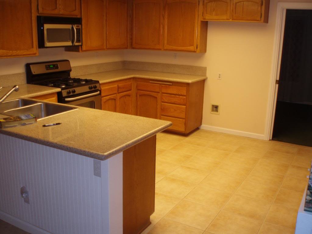

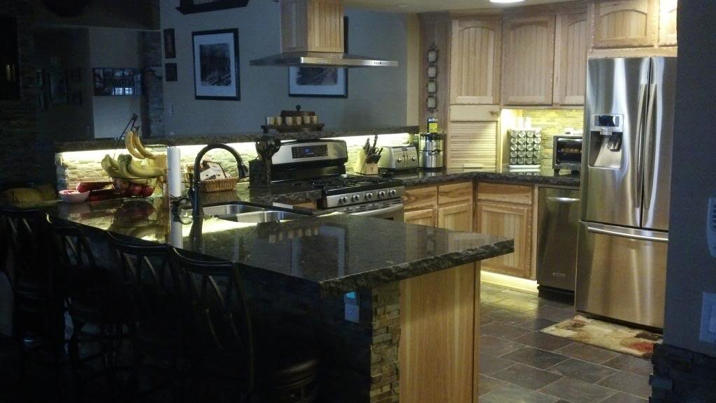

    And thats just the backyard! The inside has change drastically too. Luckily my dad didn't have to run more gas lines, there was already the lines there and he just built around them.
    Just a tip for lighting. At home depot or lowes, maybe both, they have LED strips. My dad ran those underneath the bar part and those alternate colors. Then on the front side he put them under the lip and those ones are white. On the canopy or whatever its called he used rope lights up there. They have individual switches too.
    He also ran it underneath the cabinets when he redid the kitchen.
    Heres the before picture
    He cut out the wall to open it up to the living room, since he redid that too
    Sorry for blowing up your thread with my pictures!

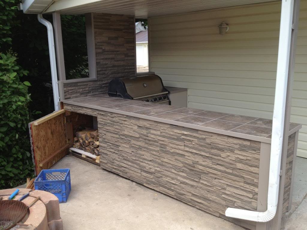

    lookin good! I like the stone idea better. My dad built this at his place. Not real stone but real easy to put up. We put in the hidden wood storage too.
