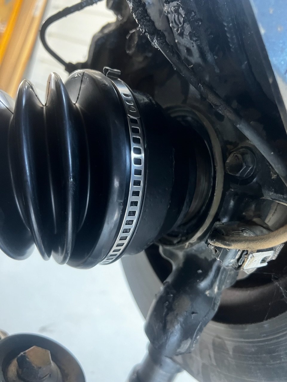

    IMG_1737.jpg Would anyone happen to know what the part number is or where I could find the seal I’m missing on my outer CV? First picture is my other cv with the correct part, second is without.
  2. Nov 1, 2023 at 5:49 PM
    zippsub9
    zippsub9 Well-Known Member
    Nov 3, 2014
    #141634
    4,569
    Halfmoon, NY
    14 DCLB
    Shit bolted onto other shit, and junk.
    90304-A0001
  3. Nov 1, 2023 at 5:50 PM
    Bishop84
    Bishop84 Well-Known Member
    Dec 17, 2015
    #172494
    11,952
    The oem dust shield may not fit the aftermarket axle. Sucks it didnt come with it.
  4. Nov 1, 2023 at 5:52 PM
    zippsub9
    Nov 3, 2014
    #141634
    4,569
    Halfmoon, NY
    14 DCLB
    I didn’t realize he said aftermarket. I thought maybe he just rebooted them using different bands.
    BREAK
    What he said…
  5. Nov 1, 2023 at 5:54 PM
    Bishop84
    Dec 17, 2015
    #172494
    11,952
    Nope Im just guessing, but I've seen issues with dust seals and the stupid axles.

  6. Nov 1, 2023 at 6:18 PM
    bako19
    bako19 [OP] Member
    Apr 8, 2021
    #362079
    22
    Mason
    2019 Tacoma TRD Off-Road 4x4

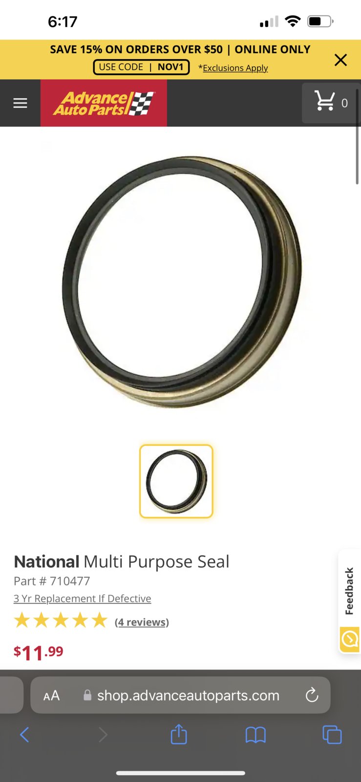

    Both sides are aftermarket axles. One broke so I took in to place I got it from and they swapped it out with a new one. Totally spaced and realized I left all the dust seals with the axle I turned in, So now I have this axle with no seals. Already got the dust shield that goes into the diff ordered, but this outer one is confusing to me. IMG_1746.png All my research leads me to think this universal seal could work. Guess I’ll find out
  7. Nov 1, 2023 at 6:25 PM
    bako19
    bako19 [OP] Member
    Apr 8, 2021
    #362079
    22
    Mason
    I can also see if my local dealership has 90304-A0001 and try that
  8. Nov 2, 2023 at 3:51 AM
    zippsub9
    Nov 3, 2014
    #141634
    4,569
    Halfmoon, NY
    14 DCLB
    That one looks like the seal that goes into the knuckle and NOT the CV seal.
