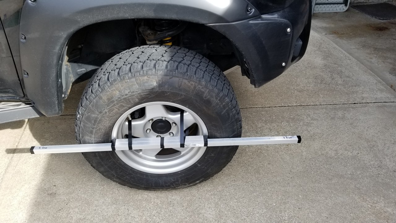

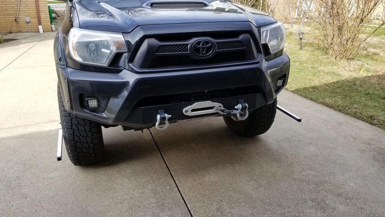

    That's because it isn't their truck they are wrenching on. Looks like excessive toe-in might be the problem, although it could be a number of things. Do yourself a favor and check/adjust the toe yourself, assuming you can turn a wrench (I don't know you so I apologize if that was an insult). If it's spot on, at least you can rule that part out.
    Buy some 1" aluminum square and build this contraption. Attach it to your wheels and accurately measure your own toe. Measure at the front and at the back, then subtract the totals. The measurements should be just about even, up to 2mm of toe in. Mine was 8mm toe in and my outside of the tires was beginning to wear like you. Easy to adjust by popping the tie rod end off the spindle arm, loosening the lock nut, and turning it a few turns. It works and is very accurate.
