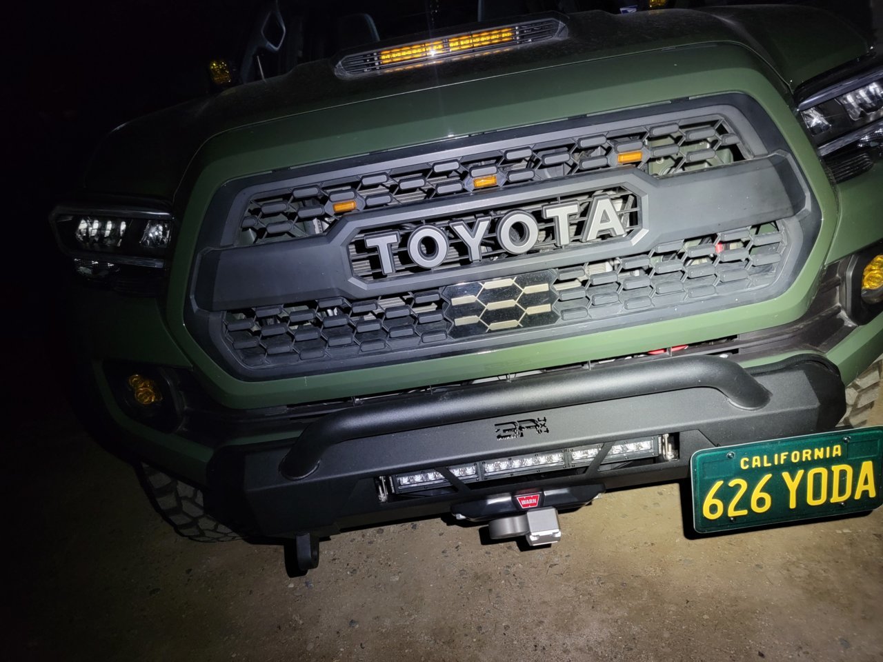

    I mounted mine on a 2” receiver post. This provides three functional benefits:
    1) I can use it front or rear whenever I need. (I have a front receiver)
    2) I can store it out of weather and sight which keeps out salt and grime.
    3) I can use it for other problems around the property and at the waterfront.

    Did you add the front receiver? Did the skid plate underneath get in the way? I do like the idea of having it mountable in front or back. Which brand did you get?

    It’s a Curt front receiver. It fits around pro plate. I may have trimmed it. I welded two additional receivers so I have off center rig points. Warn.

    NICE! Looks good. I love the personalized plate too.

    Good looking truck, but I especially love the license plate! Star Trek fan? Work in technology? Just a good personalized plate that was still available?

    All above!
