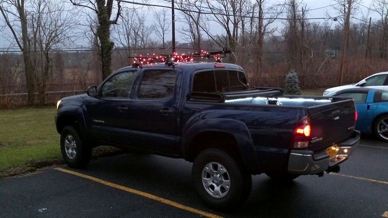

  16. Jan 9, 2014 at 2:05 PM
    #16
    belone12
    belone12 Well-Known Member
    Sep 4, 2012
    #86222
    366
    Brian
    Long Island, NY
    06 Tacoma Double Cab 6spd TRD OR
    Bilstein 5100s, AAL, heated leather seats, Thule Rack, tow package, anytime foglight, Fold-a-cover
    That's the only thing the bed outlet was intended for when they initially designed the vehicle.
