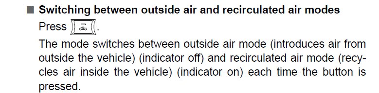

    did you check the owners manual?

    It helps!
    OP, all joking aside; if you didn’t get a printed version, you DL it on Toyota’s site. This also makes its quicker for me to use/search.

    thats right.....alot of answers can be found there

    thats what i used......go to the index and bam.....there it is

    i have checked the owner manual but my brain isn't understanding all that clearly. i think i'm doing it right but when i turn up the fan and the temperature readings light up i figure i'm using either heat or air conditioning so i turn it off.
    i thought the air recirculation button was only useful with the heat/air condition. i'll try it by itself.

    ^If the recirc button is lighted, it's in recirc. If the button is dark, it's on fresh air. Note the "passive" airflow from the fresh air intake in the cowl through the cabin filter and ducts is quite limited.
    If you want the fan to run without A/C, just set to a low temperature (a few deg below outside temp) and make sure the A/C button isn't lighted.
