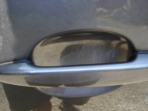

    i got 3m film for the cups ;) no scratches

    as a few others have said, the scratch x stuff works wonders or atleast did for me, along with a buffing pad. mine had a tone of scratches but not no mo. I just locked the doors so i could pull the handle and have room to get my pad in there with the scratch x and buffed the crap out of them

    It's going to happen and i just polish them out when necessary after a wash or doing a complete detail.Whats really funny is when women use the excuse that its not from them or they don't understand what the cause of this is.

    Take a little polish compound on a micro fiber and buff it out. Those will come out, as long as you do not see the metal. Cheaper than the dealer, that's exactly what they are going to do anyways.
