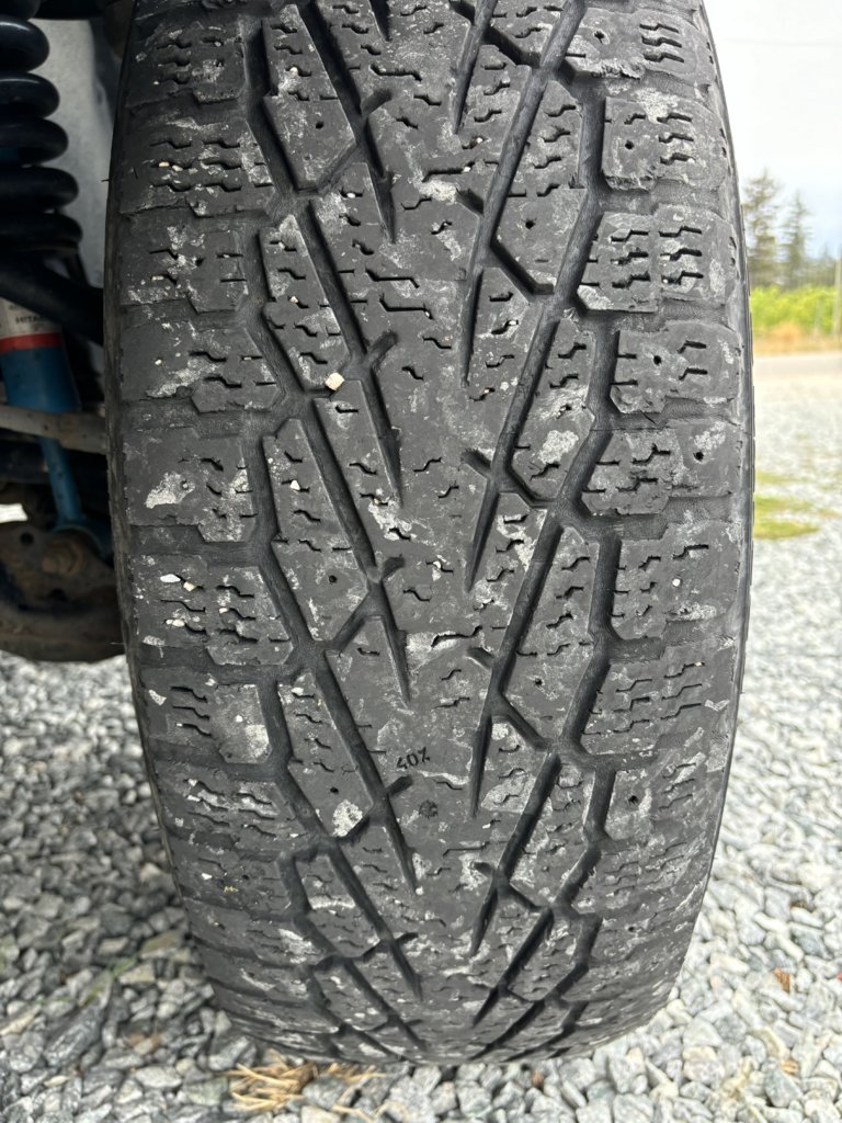

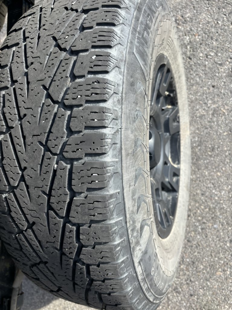

    Hey guys.
    just looking for a quick opinion on the wear of these tires.
    just a little backstory. I bought these used in Jan 2024 just to use for the winter, they were cheap. I didn’t end up taking them off in summer just cause I never got around to it and thought I was throwing them out anyways so what the point. Now I’m going to put my off road tires back on and I just noticed this outside wear.
    I took it to a tire shop to get an alignment but the owner actually said it probably just from driving the soft winters in summer. And turning on them. It gets to 40 degrees here in Kelowna BC. so I didn’t get the alignment.
    Also, my Toyo AT3s I had on before these have no irregular wear at all. Just wanna make sure this is the issue before I put these back on.
    Do anyone have any insight on this situation?

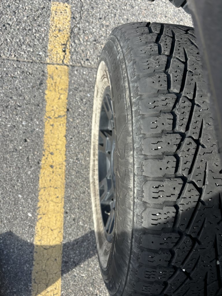

    I also included the back tire for reference.
    Thank you!

    Still Shopping
