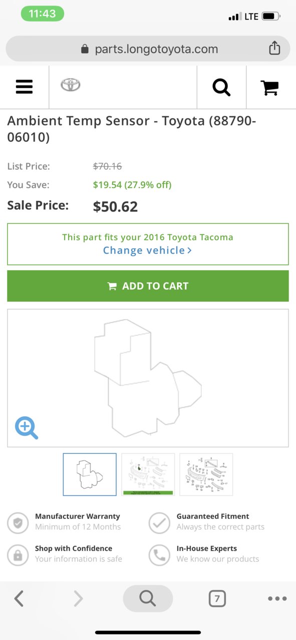

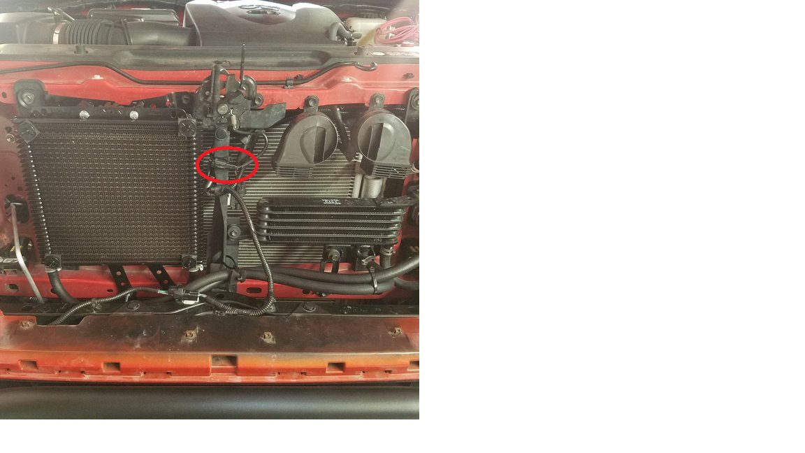

    What does this part look like? I’m trying to locate it now. Just turned the truck on first time this morning. Read 66* then 55* then 38*. It’s certainly not 38*

    Trying to locate it but having difficulty. Going back to look in there some more

    Ah shit, you figured out my screwup before I could fix it.

    Gauge is reading 34* currently. Going to get a hair drier and run it in front of it and see what happens
