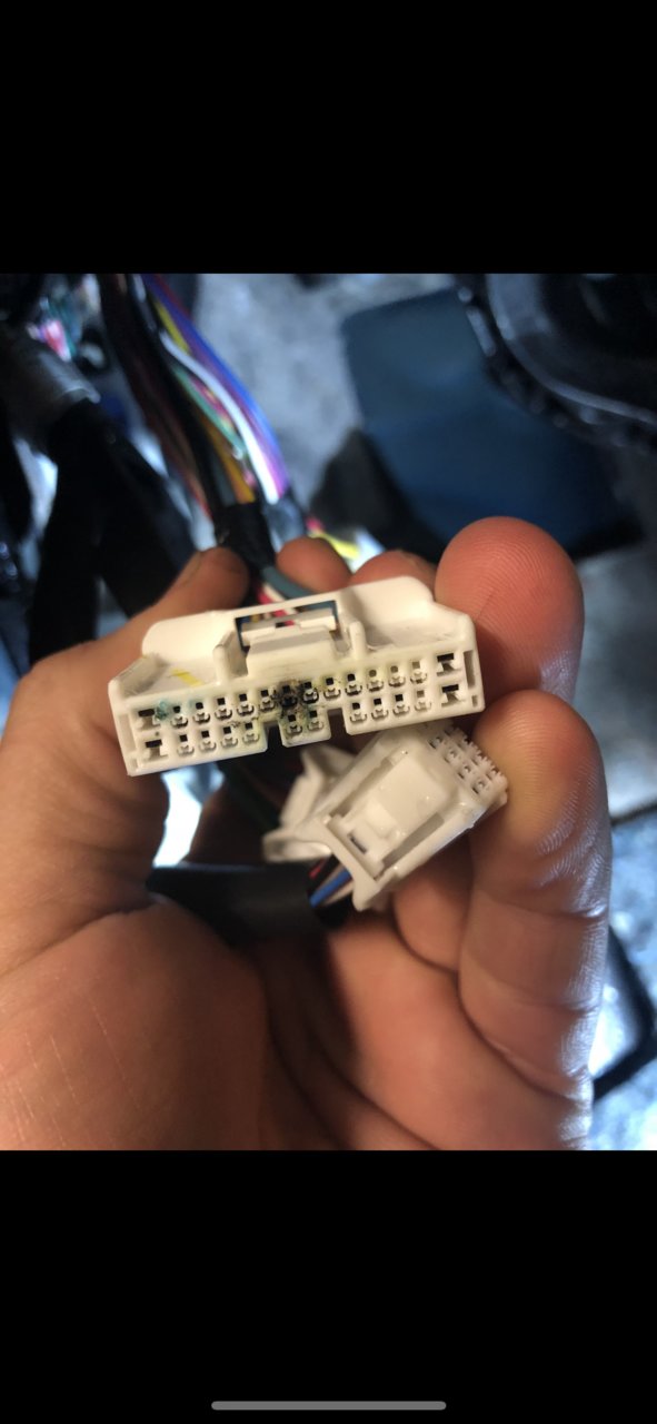

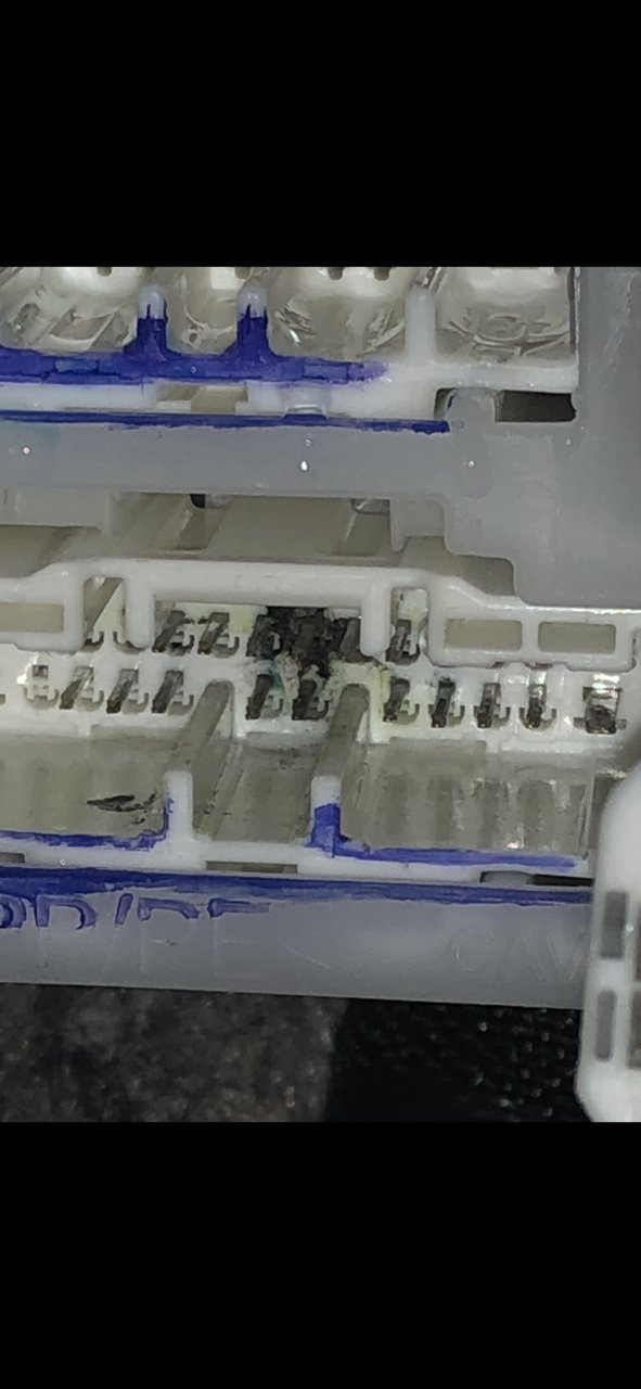

    Just something to keep in mind:
    my 17 had a cracked windshield at 500 miles, safelite replaced it and all was fine for 5 months. rainy season came and suddenly my truck started having a few issues. my outside temp gauge and my fuel level were reading very inaccurate.
    i pulled the harnesses in the driver side kick panel apart and found corrosion on a few of the wires.
    i repaired them and charged safelite to fix it, and they paid a local windshield guy to fix the glass properly. there was a small section halfway up the driver side of the glass that was slowly leaking water in.
    if you've had a windshield replaced, its something to look out for. its not all that uncommon.

    Pictures of the damage

    It all depends what wires get affected. Those two systems are in the same connector, as well as a few others. I could look it up and see what’s in that one if I get some free time later

    3,484
    J
    2016 Tacoma 4x4 V6 Metallic
    Wow that sucks.
    Wonder if we need to put a drip shield over that connector area ? Cheap insurance.
    What function is that pin that got overheated ?
