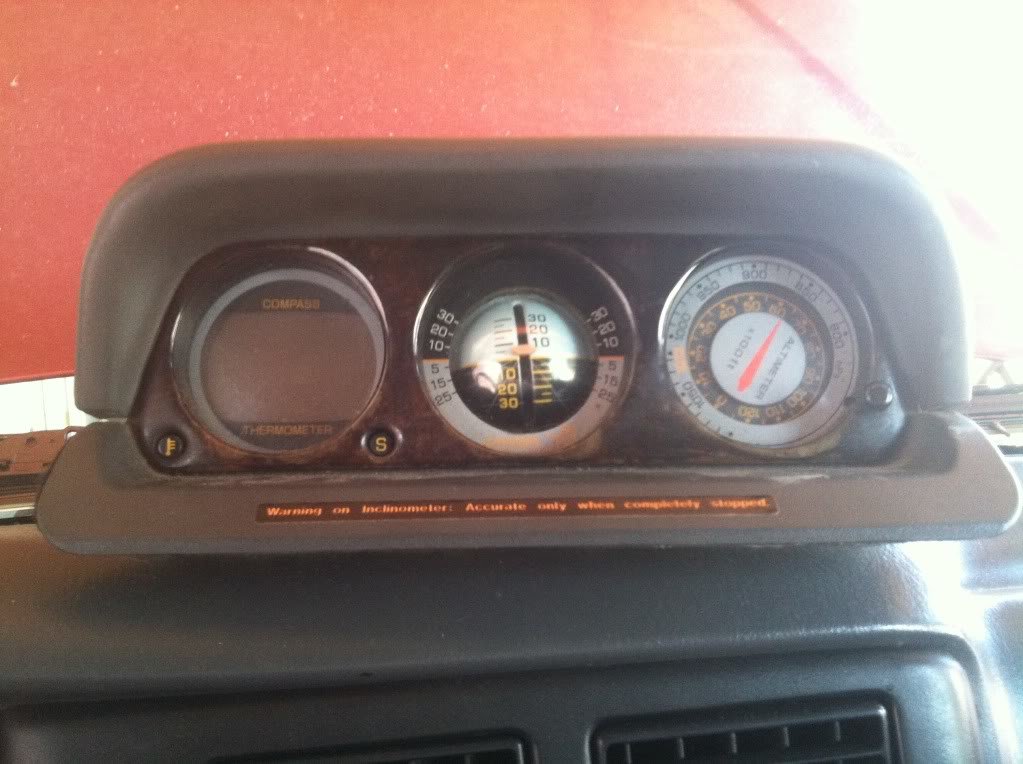

    After trying a couple of the cheap thermometer options (that wouldn't fit without dash modification, or didn't have a long enough probe), I finally found one that works WELL. Installation was relatively easy. It required NO modification of my dash and the 3m probe was simple to route all the way out to just behind the front bumper. (I removed the "F/C" character from the board and ground a fraction of an inch from the edges of the remaining left and right LEDs. I was even able to fashion a red "lens" for the front that gives the whole thing a nicely "finished" look.)
    I haven't gotten around to taking pics yet. (Sorry!)

    Having now driven with it for a few days, I can confirm it works well. I ran the sensor wire inside wire loom to protect it from damage, routing it along the driver side, and dropping it into the front fender near the battery. That allowed me to tie wrap it to one of the bumper supports behind/below the headlight. I confirmed the thermometer's accuracy, which is spot-on, with a portable laser thermometer. To prevent rapid swings in temp, I left the (metal) sensor covered by (plastic) loom. This works relatively well, though nothing seems to prevent a few degrees elevation in temp when idling.
    As promised, here are several photos of the finished product...

    Very nice job! Wish I had a spot in mine like that to put a display.

    Did you just gut the thermometer and glue it with a silicone?! I'm curious to know since I just received mine in the mail last night!
