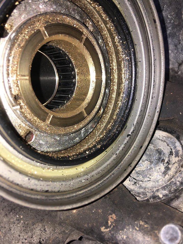

    This weekend I decided to do a reboot job on my truck. The red "high angle inner boots I was running both had multiple slices on the ribs. I pulled out the driver side CV and nothing was out of the ordinary. But when I pulled out the passenger side I found a ton of brass shavings sitting behind the hub assembly. Now my first reaction was to check if the CV axle was fully seated. Maybe it was sticking further out of the diff somehow and rubbing. But this was not the case. Then I considered my other possible issues.
    The truck was converted to manual hub 4WD while retaining ABS in November 2018. I used a machine shop to press my wheel hubs and bearings into the ABS spindle. They broke one bearing their first try and had to go buy another bearing from Toyota to finish the job. I'm not sure if it's even possible to press a hub in too far but maybe if the wheel bearing was pressed in incorrectly the hub assembly isn't seating in the correct place.
    The 4WD conversion was completed with all OEM parts. Besides the hub assembly themselves. I opted for an aftermarket DuraGO hub assembly since I didn't want to drop $400 on new ones. It could just be a faulty part and replacing it with a Toyota assembly is the fix. But again this is speculation.
    I don't have any idea on how to proceed from here without just doing the standard "parts cannon" approach. If I decide to do that I'll need to order soon or the truck will be down for some time. I currently have my project truck sitting around waiting on a November Camelbak Toyota parts order that was missing a ton of parts. And I'm selling my Tundra in a few weeks so I'd like to get at least one of my Tacomas driving again. If the successful fix to this is all new parts I'll be bothered about never figuring out the real cause.

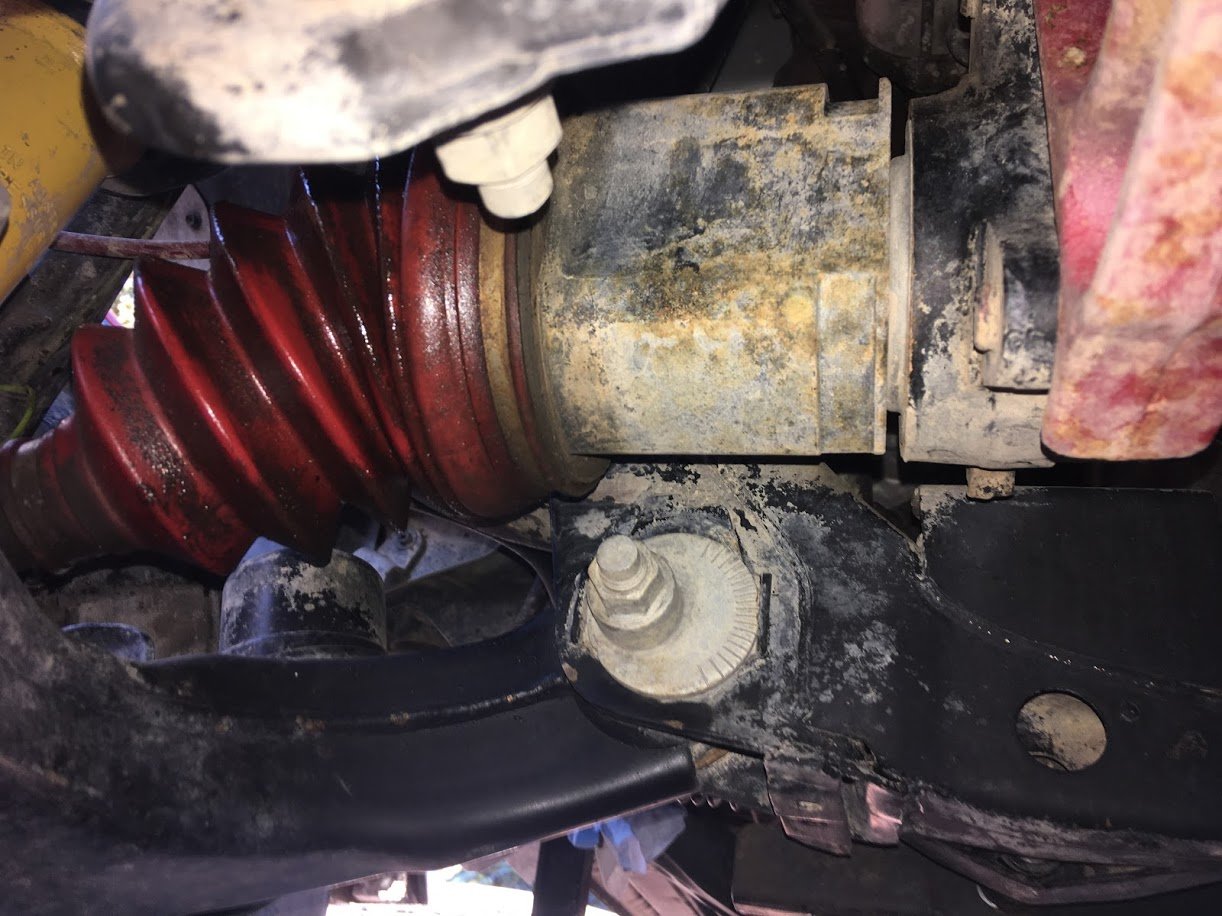

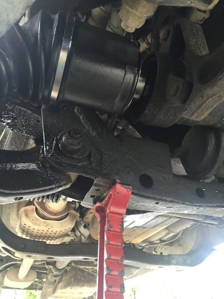

    So I don't have anything to compare to but I've taken a few CVs out of these trucks in the past year or so. And the spacing on my CV to the diff appears normal. The truck is running CVJ remanufactured axles.
    uU6mghCv8qz0q2VEwYUqvd9twUbUZoO4gUQ4Y1lt_e2451544e8a1f650303fb7ce16e7e0c0a0fcc61f.jpg
    I half expected to see something like below causing the CV to contact. But this was not the case. Replacing the wheel bearing, hub assembly, seals, etc, and buying my roommate lunch to press things in at his shop following the FSM is going to run me ~$400.

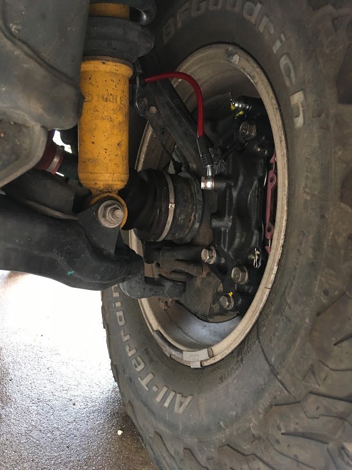

    Jacked up. I don't have great angles but they're not terrible. The suspension could do with a winch in the ARB.

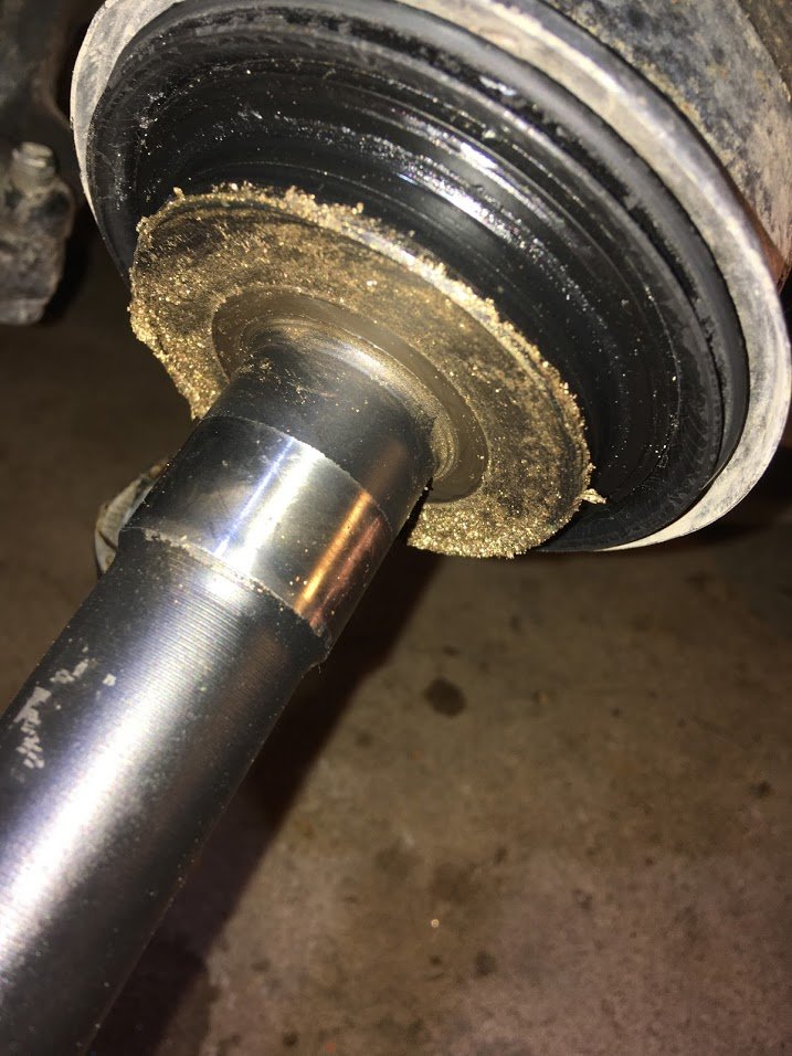

    So I'm pretty convinced this is a CV issue.
    I'd expect this kind of thing from an Autozone bottom of the line Chinese CV is the things that concerns me.

    I can't see anything visually different other than the seals. But both of my CVJ axles will rub the brass ring on all 4 of my spindles while the OEM Toyota CVs don't touch the brass ring on any.
    The CV that was rubbing enough to throw the shavings now has a groove worn around the shaft.

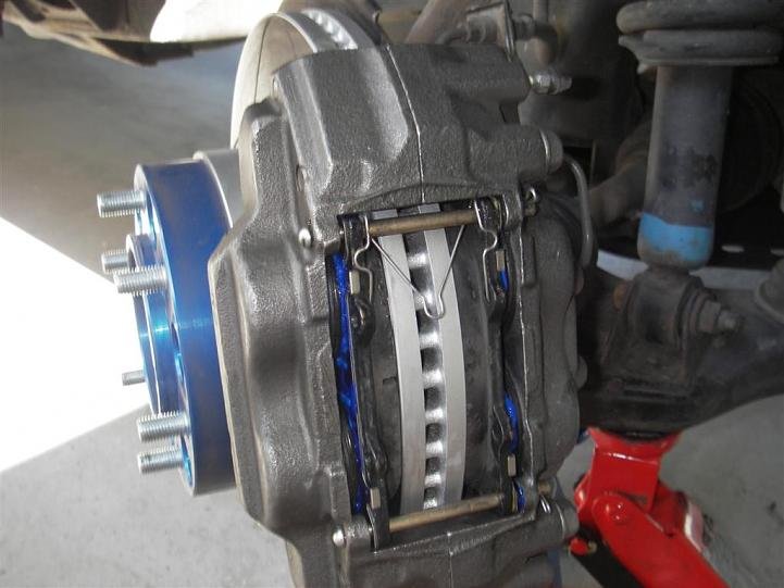

    Just looking at your whole setup here and I’m noticing on your brake calipers you don’t have the spring clip thing set up on there, is that for a reason?
  15. Jan 1, 2020 at 6:56 PM
    04Pre_Runner
    04Pre_Runner [OP] Well-Known Member
    Feb 9, 2017
    #210143
    4,859
    Andrew
    2004 DC Tacoma SR5 4WD V6
    I'm running Tundra brakes on this truck so my setup looks like this.
    83450d1280435330-tundra-brake-upgrade-ra_a8b9cc6892563fff18ce007da5383f79a651bcaf.jpg

    Is that the stock “anti rattle” spring ? Never seen one like that before
