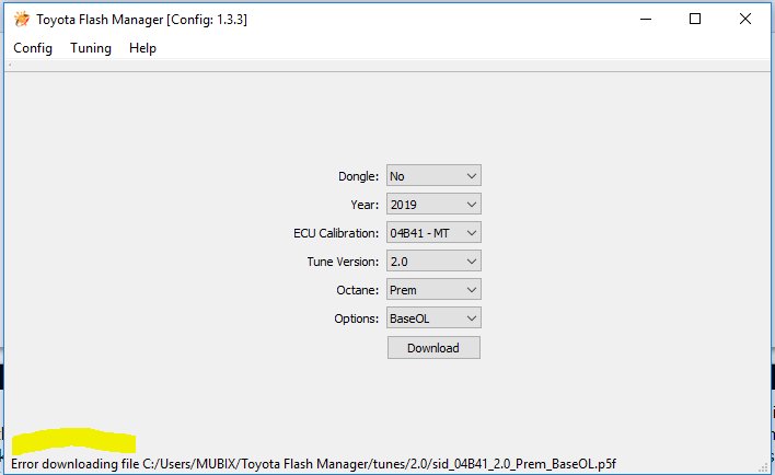

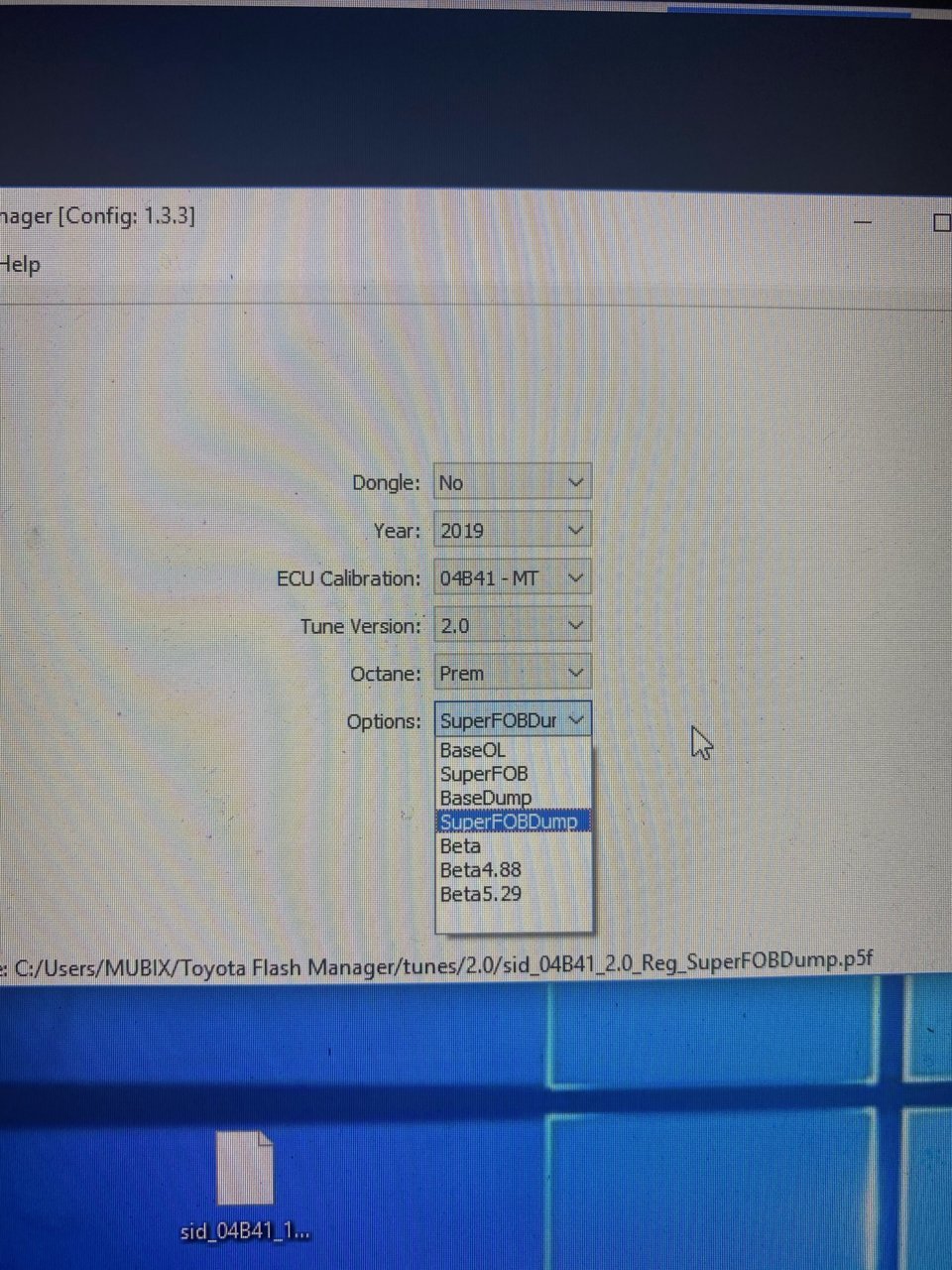

    What do the options mean in 2.0 ? When I go to the 2.0 tunes and do BaseOL it just says error downloading file (I'm assuming this means it's not available for my ECU calibration). The SuperFOB is available, is this the equivalent of "performance" in 1.05 ? I'm assuming Dump is for trucks with custom exhausts ?
    Other then clarification, my specific question is: Goal being balanced drivability and decent mpg, if BaseOL for 2.0 is unavailable for my Calibration is my best bet staying on 1.05 BaseOL ? Are they're any custom tunes available from community for this truck ?

    i also have a 19. i went 92 prem superfob or something along those lines, i forget the nomenclature. the superfob is the enhanced, more aggressive throttle response. dump is for ovts custom dump tubes. if you dont have those i would just use superfob.

    '19 6 speed here. I haven't done the base tune to compare, but I have the 04B41_2.0_Prem_SuperFOB tune
    No measurable difference in MPG versus stock, at first I actually got a little better mileage but that has since leveled off. I've always used premium gas and was told when I flashed this was my best choice and I've been very happy. As stated, this tune is for better throttle response than the base versions, but for those of us without their dump tubes.

    '19 Sport M/T here, best response overall is 2.0 Superfob premium as stated (I run 91E0 gas, because that's what I get for premium in my area).

    2.0 base is available. Are you on the most up to date version?
    I don't think 1.3.3 is right looking at your picture.
    You have vf tuner I'm assuming?
    @tonered can answer this

    I have VF tuner yes. Updated the software per instructions after I did the installation. I’ll take a look again tomorrow but when I hit download for 2.0 base it just says error downloading file currently.
    I did 2.0 superfob flash this morning and drove about 10-20 miles back and forth to the beach and to be honest I liked the 1.05 base better for lower gears. Haven’t put enough miles to say definitively but that was my first impression.
    EDIT: For reference, I confirmed I'm updated to newest version, this is the message I get when I got to download any of the 2.0 base tunes.
