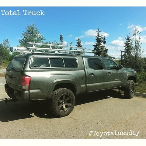

    I just purchased a camper shell for my 2015 DCSB and would like a rack for my ladders, canoe, and cartop carrier (not all at the same time). I have done some searching and found one site that sells them for only Gen1s. http://www.workvanequipment.com/PRO...Medium-Size-Truck-with-Camper-Shell_p_26.html
    When I first started looking I found one site that custom built them, but can no longer find the site. Anyone that has one of these for their Gen2?
    This Tacoma I saw on Craigslist is what started my search.

    The issue you're going to run into is that most of the shells for the newer Tacomas have lips that extend over the bed rails to help prevent leaks. I have seen where folks had a bracket that sat on the bed side then came down enough to clear the extended part of the shell and allow mounting the rack. Your other option would be to notch the shell but then you run the risk of leaking.
    After I bought my truck I bought one of those over shell racks with the idea that I would just notch the shell. After looking at it further I sold the rack (I think someone on here bought it); I just use the Yakima tracks/rack now. If you do go with one of those I would highly suggest putting silicon or some sort of sealer on the joints and bolt holes as they all seem to rust. You can pick up large diameter shrink tubing that should help as well.

    As I was about to make a 375 mile trek to pickup a Rackit over camper rack, I found out they do not fit with the lipped camper shells. Thanks for bringing that to my attention @Bajatacoma
    The search continues. Either that or I'm going to have to replace my camper with one built into it.

    i see a bunch if tacomas with the alurack around my area. I almost went with it and may still. Obviously limited by the strength of your shell but its aluminum so won't rust and only like 65lbs i believe. Has roller on the back. Easily wide enough for plywood ect. Ive seen some in yakima type tracks but I believe thats only because tracks were already there so not actually attached to rail system but still bolted through shellIMG_3222.jpg

    The weight limit on this is 165lbs. My canoe is 150lbs.
    Looking into these, it will depend on the weight limit.
