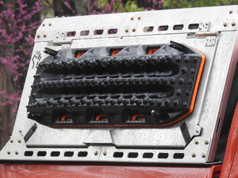

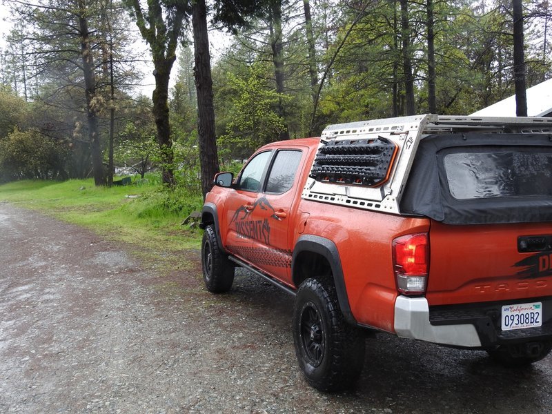

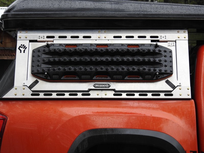

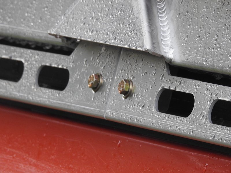

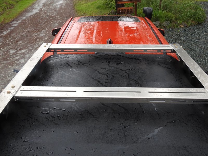

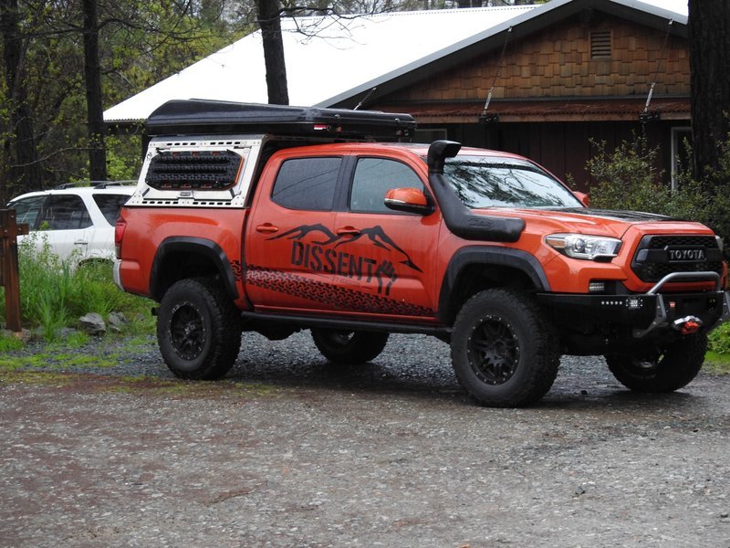

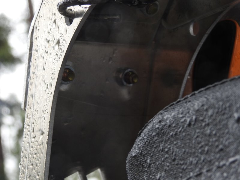

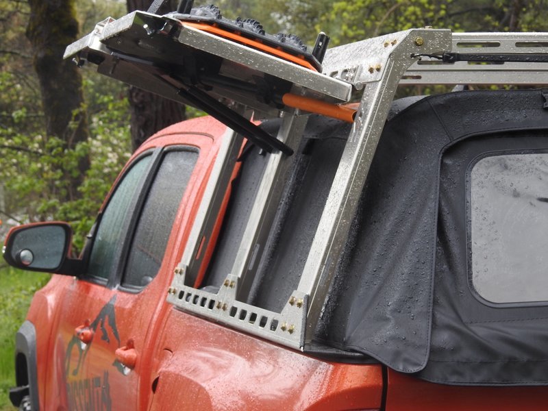

    image.jpg image.jpg image.jpg image.jpg image.jpg image.jpg image.jpg So here are some more pics and details on the rack.
    This is a completly modular aluminum 10ga rack, the rack itself is 44lbs, the optional doors are about 11-13 lbs each.
    All nuts are pressed into the aluminum making assembly a simple one man job! (Takes about an hour with a 18v impact driver)
    There are 3 12" slotted holes on each load bar for mouting any type of rtt or other accessories.
    The rack itself can be removed off the base in about 3-5 min.

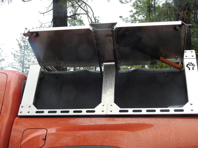

    The optional side doors/accessorie mounts are installed with stainless lift off hinges, have integrated handles and the doors will come pre drilled for maxtrax mounting pins and rotopax, however, being aluminum it is very easy to drill and mount other accessories!
    Axe, shovel, ect.
    The doors are secured with locking latches, they are supported with 1-2 gas struts depending on the accessorie mounted, 1 strut for maxtrax and 2 for fuel.
    The pricing is not set in stone quite yet but the target price will be around $1000 for the rack and $250-300 for each door which can be added latter.
    I know the price is higher than most other racks but most are made from thin gage steel and not aluminum, I have also not yet seen any with the pressed in pin nuts.
    Here are some optional accessories I plan to offer in the future.
    Under rack table mount,
    Quick release awning mounts,
    Side mount bike rack,
    L brackets for securing loads on top,
    Grab handles,
    Drop in trays on top for use without tent,
    Sealed Side slide out storage for use without softopper,
    Additional load bars,
    Cab rack that continues the same height as the bed rack,
    Cab height model,
    Below cab model,
    And more.
    Any feedback on options you guys would like to see would be welcome as well. Thanks for looking and here are some more pics.
