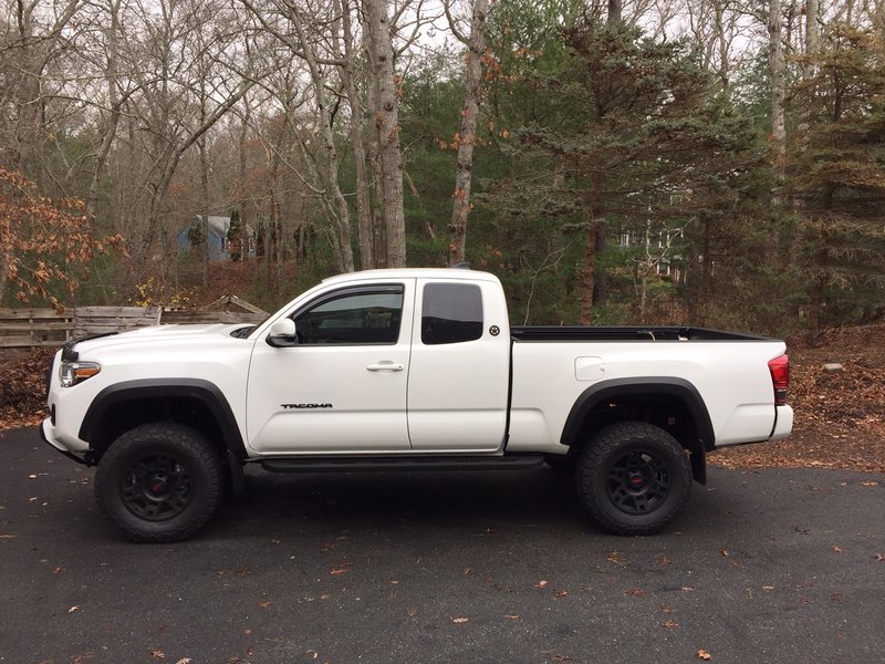

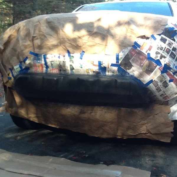

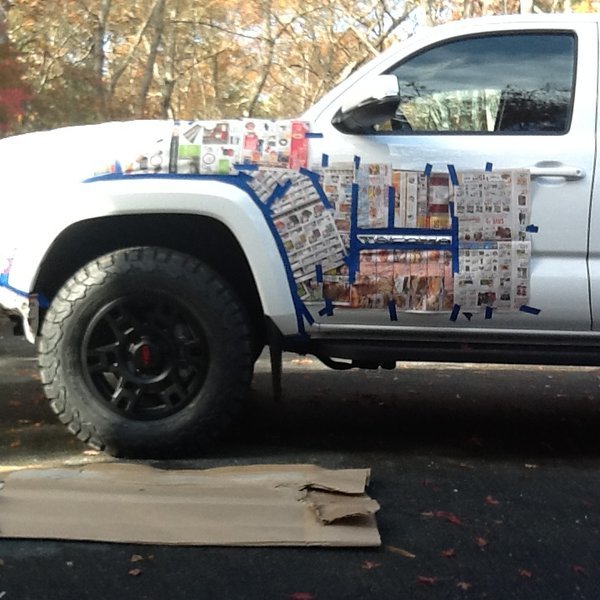

    I Plasti-Dipped mine for now. Maybe I'll paint them at a later date, but for under $20 I figured why not give it a shot.

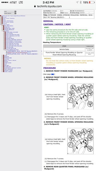

    Another thread has the instructions posted
    BBS01[OP] likes this.
