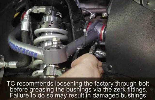

    I should have read up on this before doing it but too late. I over greased my total chaos UCA's and now the bushing is swelling. Any advice so I don't damage it while driving?

    Just pull the zerk and let the excess back out and put the zerk on. Maybe give it another pump and leave it. I think I give mine 4 pumps now because I did the same thing a few months ago.

    Pulled the zerk and it's oozing out as I type. Thanks man!
