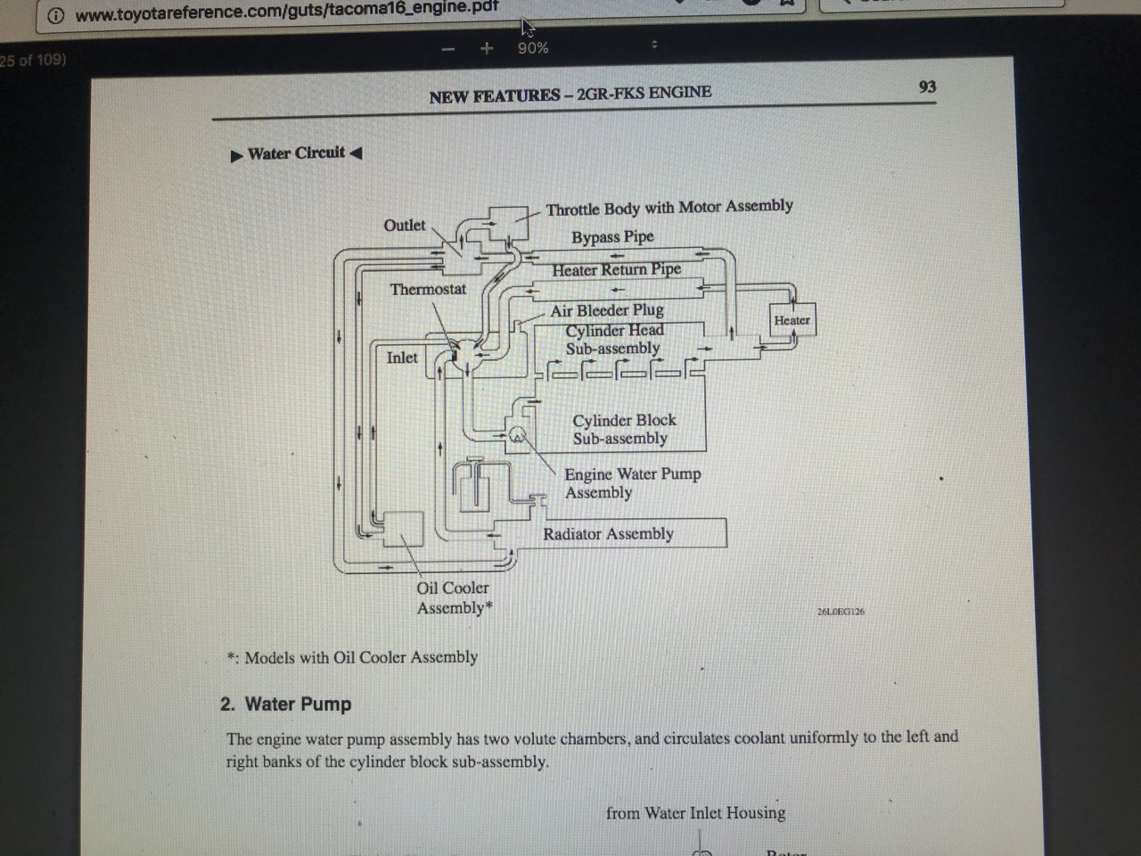

  20. Sep 16, 2018 at 7:33 AM
    #20
    Skydvrr
    Skydvrr IG: @kalopsianick
    Sep 13, 2017
    #229889
    12,653
    Nick
    YMH
    Black '17 OR
    Found this pic in the service manual. Bleeder is on t-stat housing. Couldn't find a bleed procedure but I'd crack it open and see if there's air in it. If there is leave it open to fluid runs out then shut it and top off the radiator/expansion tank.
