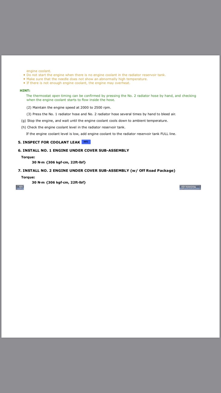

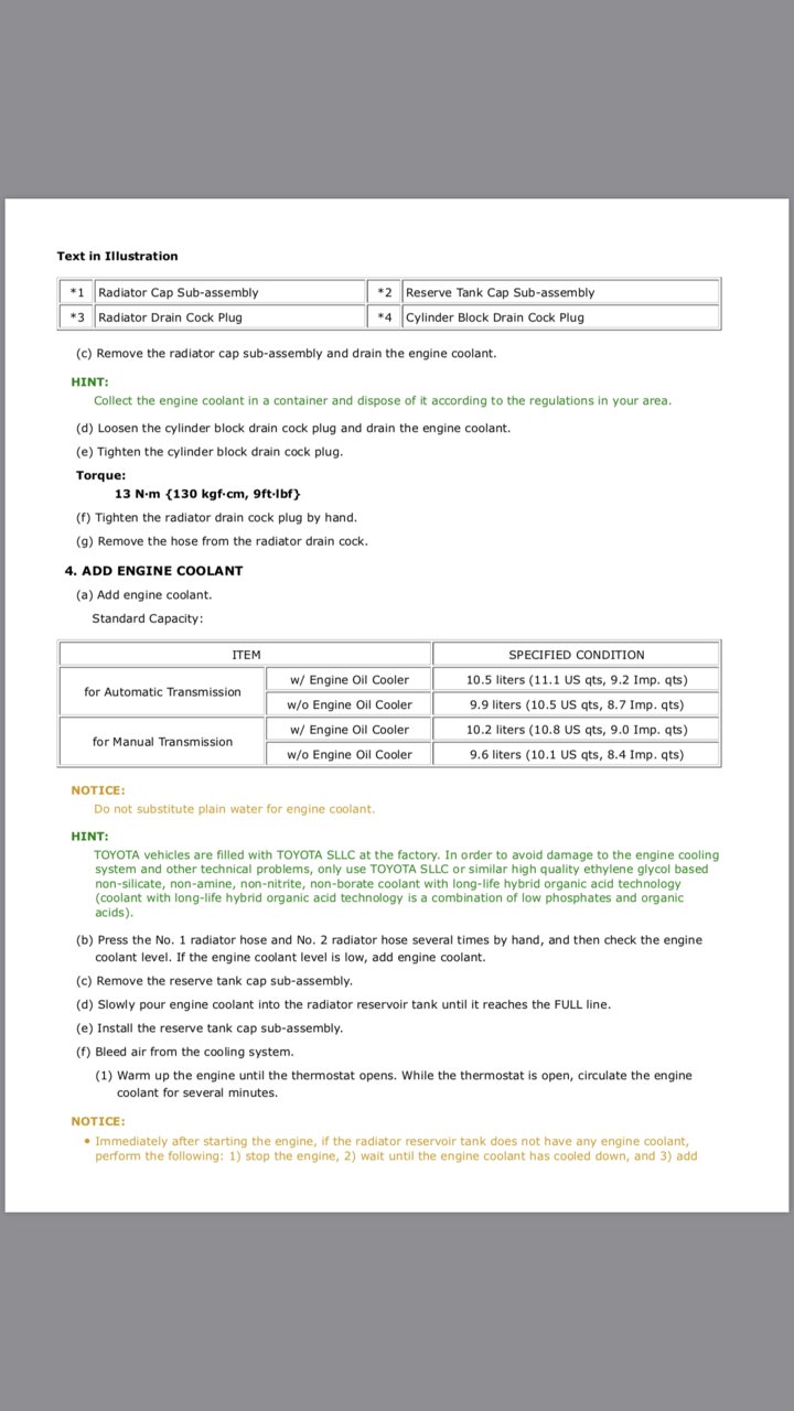

    Exactly how I feel, and exactly what my other friends with Toyotas have experienced. We followed the same procedure when cleaning my radiator as we did a friend with the 3.4 and his truck now runs fine again. I did follow the procedure in those screenshots, and nothing improved
