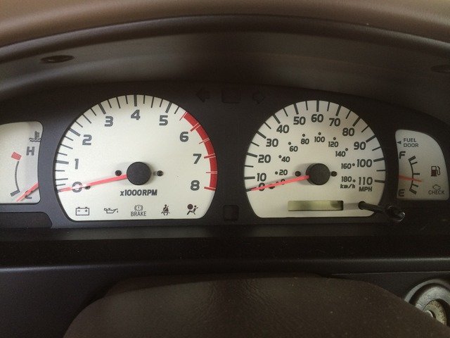

    Does your tach look like this?
    This my tach, same truck, 2001 3.4L auto. If it doesn't look like this you might have the wrong gauge cluster.

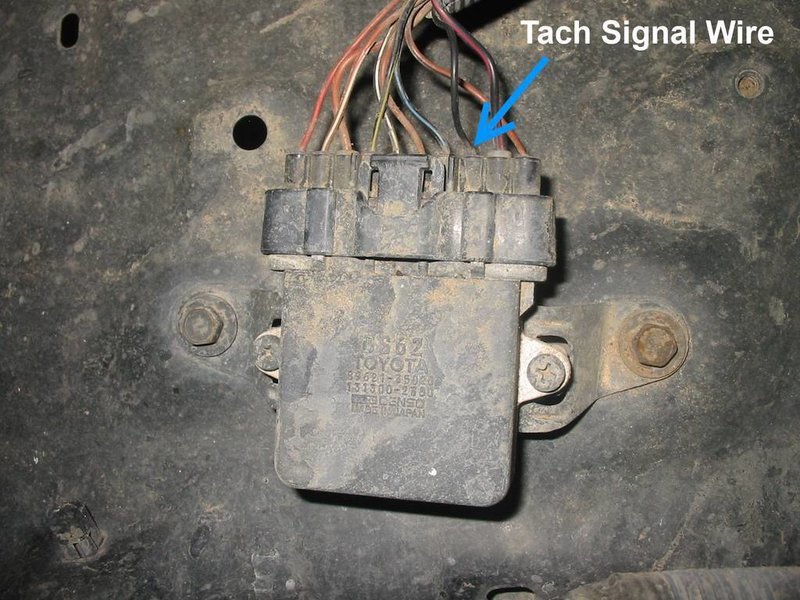

    Maybe the ignition ignitor is bad.
    Located on the passenger inner fender by cruise control module
