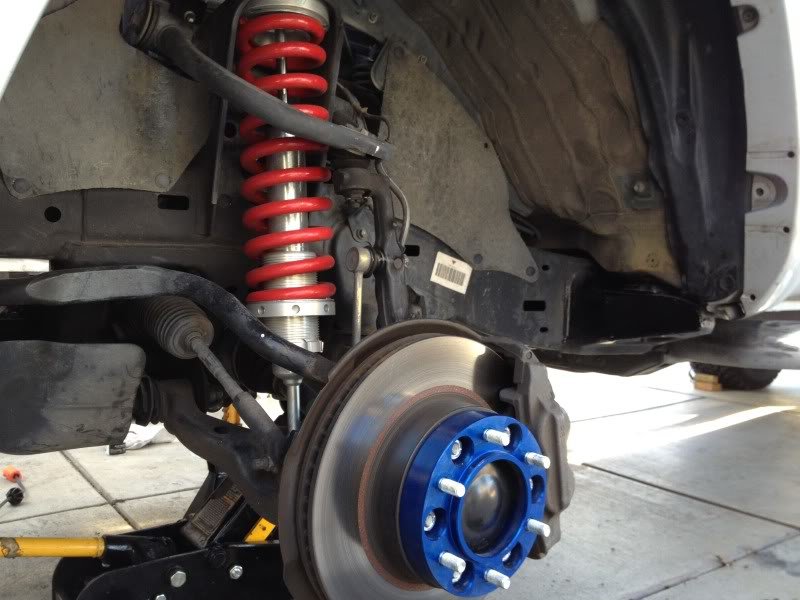

    I bought 285/75/r16 tires for 2009 tacoma 4x4 trd like and idiot without researching enough. l I put a two inch leveling kit in front. the tires are still rubbing on the inner frame when I turn com. 1.5 spacers don't fit due to hitting outer frame. Will these tires work if I put a 3 inch lift? 4in. Or am i screwed with this tire size?

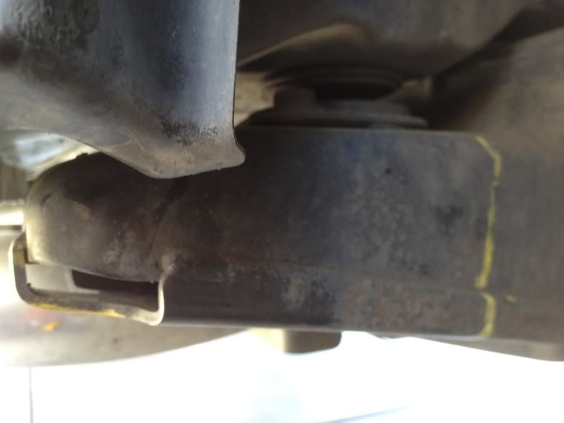

    if its only hitting the frame you need to do the cab mount chop

    Op search cab mount chop this is normal

    get different wheel. you can move the tire out with spacers but the back spacing is the gonna be the same

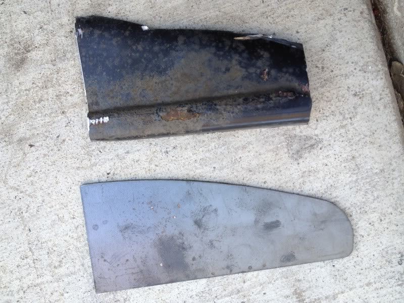

    i'm assuming you're using the stock wheels. my buddy has a similar setup. he was able to clear everything with spacers and doing the cab mount chop. it's real simple to do. just find a buddy that can weld;).
