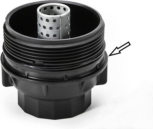

    The entire problem is caused by over tightening the housing, especially if using some inaccurate piece of shit torque wrench. When the stop flange makes contact with the engine, stop turning the housing. That's it. Period.

    The Oring seals the housing. Torquing it to a bazillion foot pounds or .0006 foot pounds has no effect on the degree of seal that Oring provides.
    So, don't apply any torque once it's on.
    The aftermarket metal filter housing is nothing more than an equipment solution to an operator error.
    If someone is capable of Fing up the process with a plastic part, they are probably just as likely to F it up with a metal part.
