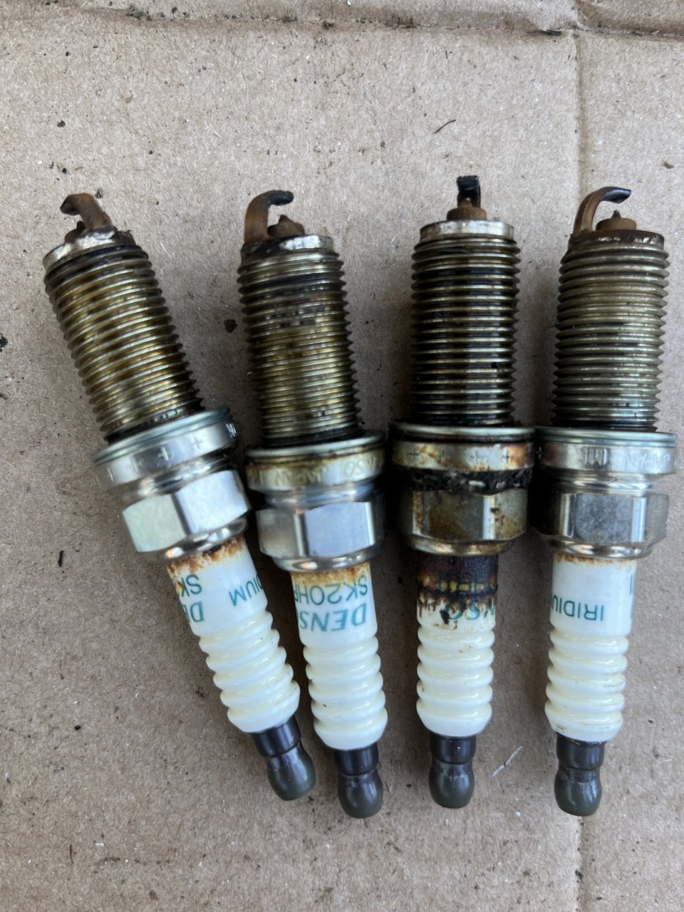

  18. May 3, 2023 at 9:31 PM
    #18
    dutd33
    dutd33 [OP] Well-Known Member
    Feb 27, 2016
    #179589
    76
    My dirty plugs at 171,000 kms.

  20. May 4, 2023 at 8:50 AM
    #20
    XSplicer62
    XSplicer62 Well-Known Member
    Nov 28, 2019
    #311979
    420
    Jefferson State
    2005 Tacoma DC TRD OffRoad
    So about 106K miles. Obviously way too long between plug changes, even if they are iridiums. Thanks for the pics! :thumbsup:
