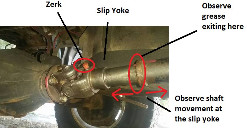

    No 5th gear on the 04 Tacoma. 4 gears; the 5th "shift" you feel is the lockup clutch. 4th should engage around 35-40 and the Lock up at 50 with ECT Normal and 60 with ECT Power engaged.
    TBH, it sounds like axel wrap, especially with the "thud" but never heard of that during highway driving. Do you get it at launch and when stopping?
    Fluid changes on transmissions are always good but before you go to a trans shop and start throwing money at this, try greasing up your drive shaft, especially by the splines (where it connected to the rear axle). Grease this one until you see the slip yoke expanding and grease start coming out along the shaft. If this "fixes" the thud, its only temporary but its cheap. Consider new leafs or helper leafs as well as new shocks.

    Fluid change won't hurt but I would expect bad fluid to manifest itself through all gear changes. Could be a bad lockup clutch.
    Before going down that long and expensive road, do yourself a favor and hit this grease fitting with a grease gun until that slip yoke starts moving and you see grease come out at the seams as expertly illustrated below:
    Other zerk fittings on your u-joints won't hurt.
    Glove and many disposable towels are your best friend here.
