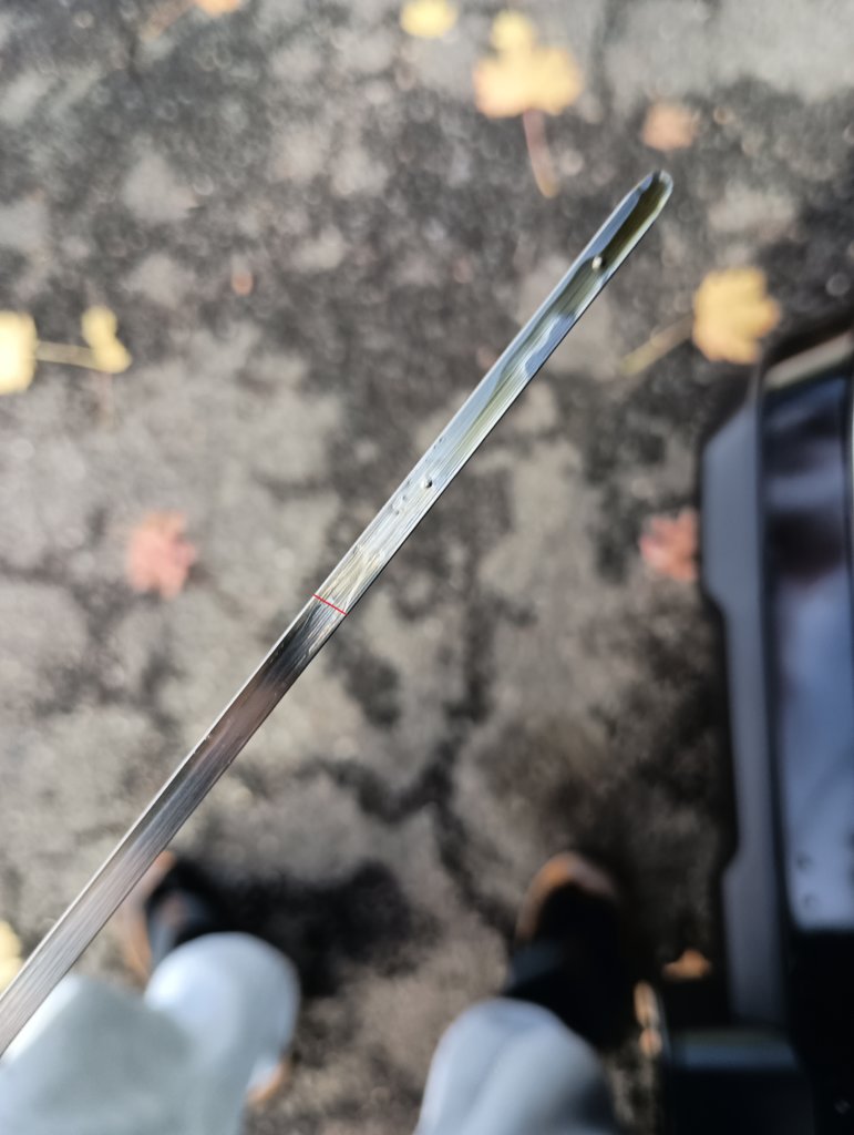

    I am not able to get accurate reading, its always reading over the top mark. I did 5 times and after waiting 20 minutes, then it read just by the top mark not over.
    Does this look like overfill? I am confident that I put 5 quartz together in filter & in engine.
    Then I topped it 1 quartz and bit more, since capacity is 6.2 Q.
    I am confused if its overfill a little or just dipstick keeps grabbing some from the tube.

    Dude, pour 6 quarts in there and call it a day.

    Since it’s not possible to fully drain all the oil out… if you put the full capacity back into it, you’ll be over

    It's normal, 6qts and b done. In a week check it b4 u start it. It'll b right at the full mark.

    I put 6 in every time. I barely look at the dipstick anymore... probably not the best practice, but i always empty my oil drain pan back into the empty jugs so i know i put it all in.

    Try wiping the dipstick and shove it back in. Wait 20 minutes and pull the dipstick out and do NOT wipe it. It should be easy to read the level.
    In 9 years of changing my oil, 6 quarts always gets me to around the top dot on the dipstick.

    This dipstick design is an absolute fucking nightmare. The best way of checking and you only get 1 shot … get the truck warm… park on level surface …. Wait 5 min and pull the stick once. That’s the only way to get a reading the rest will be smear city all over the stick

    I eventually gave up on this issue and accepted it will always be a little over.

    what's the hazard to being slightly overfilled?
    this isn't a high performance engine.
    the pistons aren't horizontally opposed.
    it's not dry sump.
    the oil pan sits lower than the crank by a good bit.
    what hazard exists here?

    Hazard is the bubbling that overfill can cause. I am just trying to understand if I overfilled it or not, I put the 6.1/6.2 from what manual said. I am confused how can dipstick be showing that up high. I left the oil draining full hour, wonder how much could have been left inside.
    I just cant tell if its rubbing on tube way out, or its overfilled, very annouying

    It’s fine
    I’ve done 6 and 6 .2
    Don’t stress over it

    now run the motor for 1 minute, shut it down, and immediately check it. it'll likely be under-filled then.
    there's a lot of oil that goes to the top of the motor. a little extra on cold start will not cause bubbling.

    A little overfill won’t matter. I always add a few ounces of Motorkote additive after an oil change…have done so since buying truck. Always add on top of supposedly full. No need to read the dipstick unless you have a leak or are burning through oil.

    Try scuffing the wetted area of the dipstick with some medium sand paper, you don't need to go crazy, just dull down the smooth finish. Only sand across the stick, it helps - a little.

    Just drained about 250ML. Going to start her up and let it sit sometime after to see
