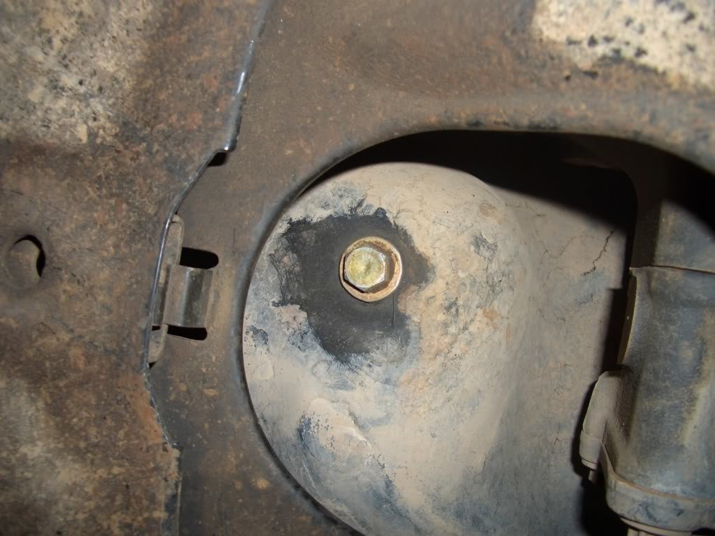

    Ok, I'm quite capable of doing something dumb like that. I drained out of the big pan in the middle! I'll take a pic and post...

    Yes. Pictures.
    The big one in the middle sounds like the Transmission.

    I drained the fluid from the bolt right in the middle, in the big flat pan. Is that the transmission fluid?? Yeah, I'm that ignorant. I can pour it back in through the transmission fluid thing on top. Is that okay to do? Then I can see about changing the oil.
    That would explain why it looked red and not a clear or brownish color...

  11. Jan 16, 2021 at 10:39 AM
    TnShooter
    TnShooter The TacomaWorld Stray
    Sep 2, 2010
    #42625
    20,912
    Deogee
    07' TRD Off-Road, Auto
    STOCK
    That’s the transmission.
