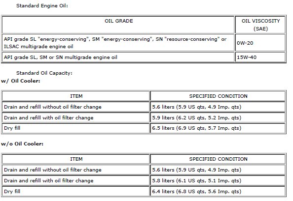

    A little bit of confusion about oil capacity evident in this thread. This is from the FSM (last modified 02-19-2019) for the 2GR-FKS engine. Take a look at what it says, then someone start a new thread on 15W40.

    Damn, looks like I have been overfilling for 67k miles. Will it buff out?
