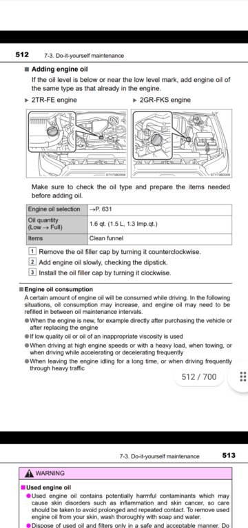

    The manufacturers are changing it so they can burn more oil without complaints. It reminds me of the f150 I traded in that burned quite a bit. They changed the dipstick

    I find the dipstick accurate, no need to sand or anything.
    What I do is, I make sure I park on a level ground. After turning off the engine, I remove the dipstick and wipe it clean. I wait 15 to 20 minutes to let all the oil go down the pan. The residue oil that went to the dipstick pipe will also drain down. I put the dipstick back all the way, wait 1 to 2 seconds, pull it back out... it should give you a clear reading, make sure you look at it at different angles as light plays with it sometimes.
    I also noticed my new Taco was overfilled from factory with more than half a quart of oil.
    My question is, if this was deliberate and Toyota expects the engine to burn a little more oil during break in period.
